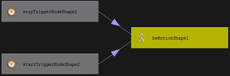

By default, when created, a Behavior will automatically create two linked Triggers.
A Behavior with two automatically created Triggers

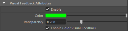

Visual Feedback Attributes
These attributes are provided to help during debugging and improving the scene. Visual Feedback is contextual according to the current Behavior, and can be displayed and also configured in the Crowd Visual Feedback.
Caution:
Notice that several Behaviors are provided with their own Visual Feedback Attributes. Please refer to these Behaviors pages to a complete overview of each attributes.
Enable Show or hide the Behavior in the Crowd Visual Feedback
Color Color used for the viewport Visual Feedback
Transparency Alpha of the Color
Enable Color Visual Feedback If checked, Entities get colored depending on which Behavior they are playing. The checkbox also needs to be checked on the relative Crowd Field.
