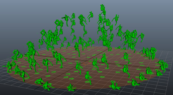

Example of a simple explosion created by a Force Behavior (using impulse)
To use a Force Behavior, the physics mode of the bones should have been switched to Dynamic Rigid Body with a Physicalize Behavior.

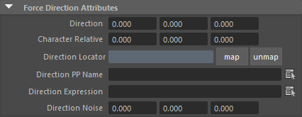

Force Direction Attributes
Those parameters configure either the impulse or the constant force (defined in the Force Mode)
Direction Direction of the force (in world coordinates)
Character Relative Direction of the force (relatively to the root of the character, in character local coordinates, the character facing the X Axis)
Direction Locator Maya Locator defining an force direction (from the locator to the root of the character)
Direction PP Name Name of the vector per-particle field of the relative particle system, containing the force direction (in world coordinates) (for more explanation about how to use ppAttributes, see ppAttributes Handling)
Direction Expression Expression to fetch the direction of the force
Direction Noise Amount of random to be added to the computed direction. E.g with a Direction set to (1, 1, 1) and Direction Noise set to (0, 1, 2), the computed direction will be in the  (1, [0..2], [-1..3]) range
Note that it's possible to use all these directions together, the final computed direction being the sum of them.

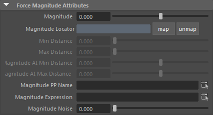

Force Magnitude Attributes
Note:
Note that the force magnitude can be positive (e.g. repulsion from the direction locator) or negative (e.g. attraction toward the direction locator)
Magnitude Magnitude of the force (in m/s for the Impulse mode / in newton for the Constant Force mode)
Magnitude Locator Maya Locator used as a reference point for distance related attributes (see below)

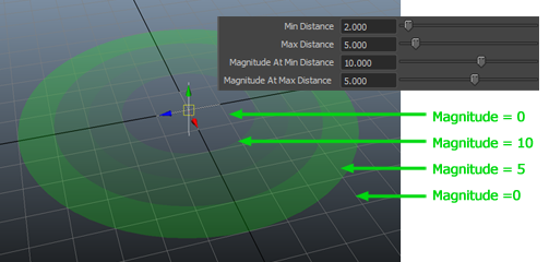

Min Distance Minimum distance between the locator and the character for the force to be applied (in Maya units)
Max Distance Maximum distance between the locator  and character for the force to be applied (in maya units)
Magnitude at Min Distance Magnitude of force (in m/s for the Impulse mode / in newton for the Constant Force mode) at the minimum distance between locator and character (it then grows linearly until Magnitude at Max Distance) (see example below)
Magnitude at Max Distance see above
Magnitude PP Name Name of the float per-particle field of the relative particle system, containing the magnitude of the force (in m/s for the Impulse mode / in newton for the Constant Force mode) (for more explanation about how to use ppAttributes, see ppAttributes Handling)
Magnitude Expression Expression to fetch the magnitude of the force
Magnitude Noise Amount of random to be added to the computed force. amount of random to be added to the computed force. E.g with a Magnitude set to 1 and Magnitude Noise set to 2, the computed magnitude value will be in the [-1 ; 1 ] range.
Influence of the Magnitude at Min Distance & Max Distance
Note that it's possible to use all magnitude modes and noise together, the final computed magnitude being the sum of them.

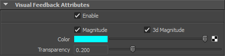

Visual Feedback Attributes
Defines the Force Behavior Visual Feedback displayed in the Crowd Visual Feedback and inside the viewport. For common Visual Feedback attributes see Behavior Common Attributes.
Notice that these attributes can also be configured in the Crowd Visual Feedback
Display Attributes of a Force Behavior

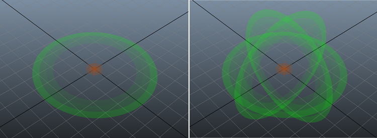

The Force Behavior provides a way to display the Min Distance and Max Distance from the Magnitude Locator.
Magnitude Enable or disable the magnitude. See capture below.
3d Magnitude Enable or disable the 3d Magnitude. See Capture below.
Color Color of the locator
Transparency Transparency of the locator
Display of a Force Behavior (magnitude and 3d magnitude modes)
