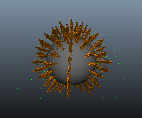

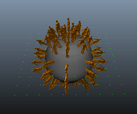

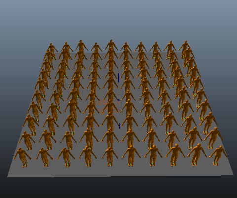

Characters (left) are transformed from a planar ground to a spherical
one (right)
UV Pin allows characters to be transformed from a terrain geometry onto a destination mesh. It uses the UV for computing the corresponding transformation

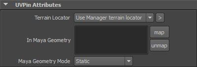

A UVPin Behavior defines the following specific attributes. For common attributes see Behavior Common Attributes.
| Terrain Locator | Terrain Locator which is used by the behavior. It is used by Entities to adapt their feet to the ground, reach a target with a Go To Behavior and avoid other Entities with the Navigation Behavior. The Terrain Locator can be overriden in each Crowd Field if required. |
| In Maya Geometry | The pinning destination Maya polygons. If several polygons are listed in the "In Maya Geometry" attributes of the Terrain Locator, several destination polygons can be defined in this Behavior (listing order matters!) |
| Maya Geometry Mode | Specify whether the geometry to pin on is Static (non moving), Dynamic Transform(geometry transform changes each frame) or Dynamic Mesh (Mesh vertices and transform change each frame). Refreshing geometry can take a huge amount of time per frame.

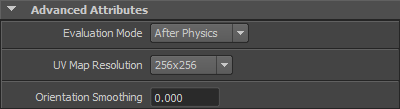

| Evaluation Mode | Specifies if this Behavior should be evaluated before of after the Physics Behaviors. |
| UV Map Resolution | Resolution of the internal texture map used for space change. Increase the size if the terrain is huge and needs extra details. |
| Orientation Smoothing | Orientation Smoothing, when using highly sloped terrain, reduces orientation jittering and fast direction changes. Smoothing is not done over multiple frames, it's done with multi-sampling. |
