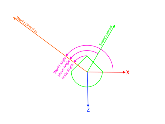

World Direction is a Vector3 representing a direction in world coordinates in the environment.
World Angle is the angle it forms with the world X axis, Body Angle the angle it forms with the entity front axis, and Move Angle the angle it forms with the entity moving direction (speed)
