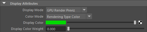

Display Attributes
Display Mode
Mode used for preview rendering  (see below)
Color Mode
  • Rendering Type Color - use the Rendering Type color defined in the Rendering Attributes section
  • Entity Type Color - use the color defined by the Display Color attribute below.
Display Color Diffuse color for the Entities belonging to this Entity Type. When particles will be emitted from a Population Tool Locator, the rgbPP PPAttribute of the particles will be set to this color (for more explanation about how to use PPAttributes, see PPAttributes Handling). By default, the color of the Entities will be the one stored in the rgbPP PPAttribute. It is also possible to use the color defined in this attribute by unchecking the "Use Rgb PP" checkbox in the Crowd Manager Display Attributes.

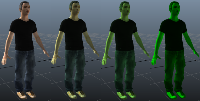

Display Color Weight
Weight of the Entity Color in the final shading.

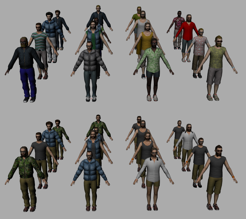

Shading Diversity
Enable viewport shading diversity. This includes texture diversity using Switch shaders and color variation using HSL shaders.
Shading Diversity enabled (above) and disabled (below)

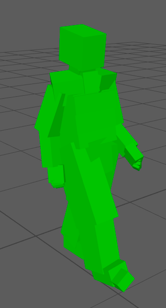

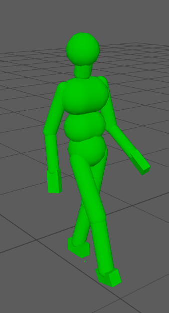

Skeleton Shapes and Physics Shapes
The same entity viewed in "Skeleton Shapes" and "Physics Shapes" modes

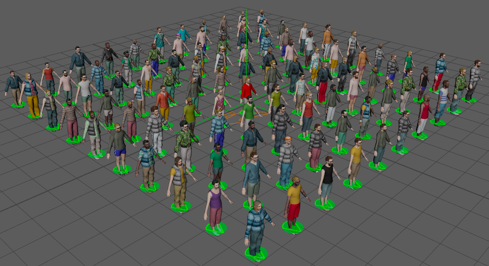

Render Previz shows geometry with asset repartition
Render Previz is available if you assign a Rendering Type to the current Entity Type. Once you set up the Character with the assets repartition and a corresponding geometry file (fbx or gcg), the Entities will be properly rendered. You will see the same mesh asset repartition as in your Simulation Render.
The Render Previz will search and use the shader assets (diffuse texture or diffuse color) applied to the mesh. An orange Diffuse color will be used if the shader is not present in Maya. For more comfort, the diffuse textures are loaded in the background. You may see them pop when running the simulation for the first time. The shader output plug color name used can be changed manually see "Color Attributes Names" below. If the geometry file is modified, you can refresh the Render Previz using the Refresh button in the attributes or using the Refresh button in the Character Maker.

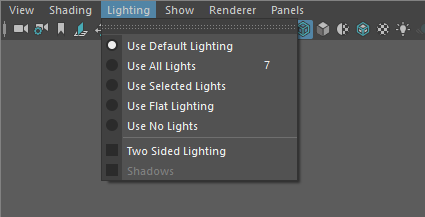

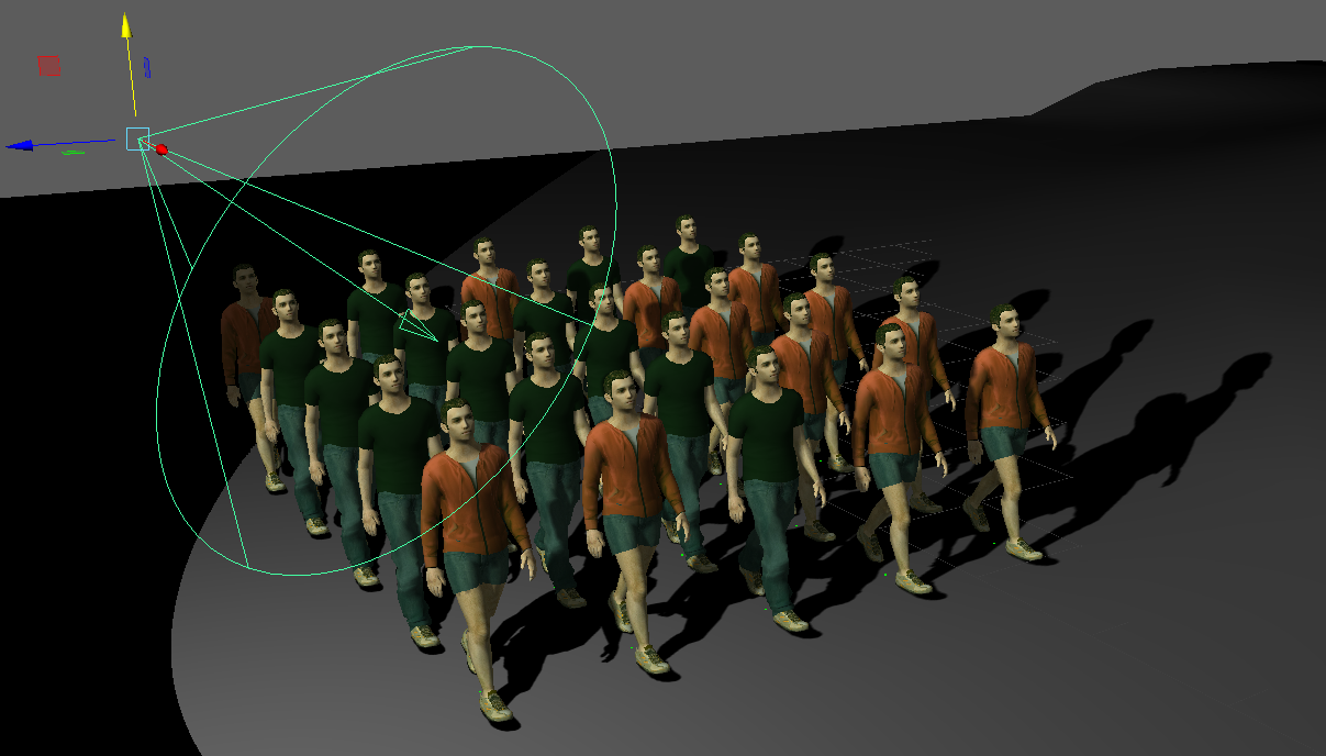

Previz Lighting
Maya viewport Lighting Panel
Previz supports up to 16 lights which can be either spot, omni, ambient, point or directional Maya lights. Use the Lighting menu in the viewport panel to activate it.
*Shadows are supported when using Viewport 2.0*

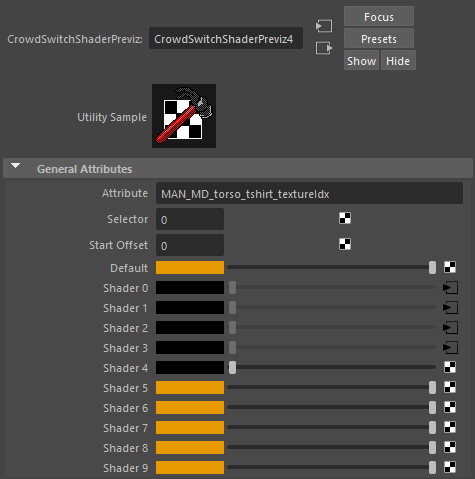

CrowdSwitchShaderPreviz
The Crowd Switch Shader for previz lets you add visual diversity on Crowd Entities in the viewport (simulation or cache replay) by applying different textures or shaders on the same mesh on different Entities.
Attribute Name of the Shader Attribute to use for the Selector.
Selector Value determining which input will be used. Unlike renderer switch shaders, the Selector doesn't need to be connected to another node, as the Shader Attribute is already given by the Attribute parameter.
Start Offset Value subtracted from the selector value when choosing the shader. It is used to create chains of Switch Shaders when more than 10 inputs are needed
Default Default shader to use if no shader corresponds to the Selector value
Shader 0 to 9 Input shaders/textures slots corresponding to the Selector value (e.g. if Selector value is 0, Shader 0 will be returned as output)

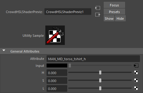

CrowdHSLShaderPreviz
The Crowd HSL Shader for previz lets you add visual diversity on Crowd Entities in the viewport (simulation or cache replay) by changing the hue, lightness or saturation of a shader or texture applied on the same mesh on different Entities.
Attribute Name of the Shader Attribute to use for the Selector. One vector Shader Attribute or up to 3 float Shader Attributes separated by ; can be used, e.g. to change only the saturation use ;[saturationAttributeName];
Input Input shader/textures to modify
H, S, L Hue, saturation, lightness parameters (between -1. and 1.). 0 means that the parameter will have any effect on the input shader/texture. Unlike renderer HSL shaders, these values do not need to be connected to other nodes, as the Shader Attributes are already given by the Attribute parameter.

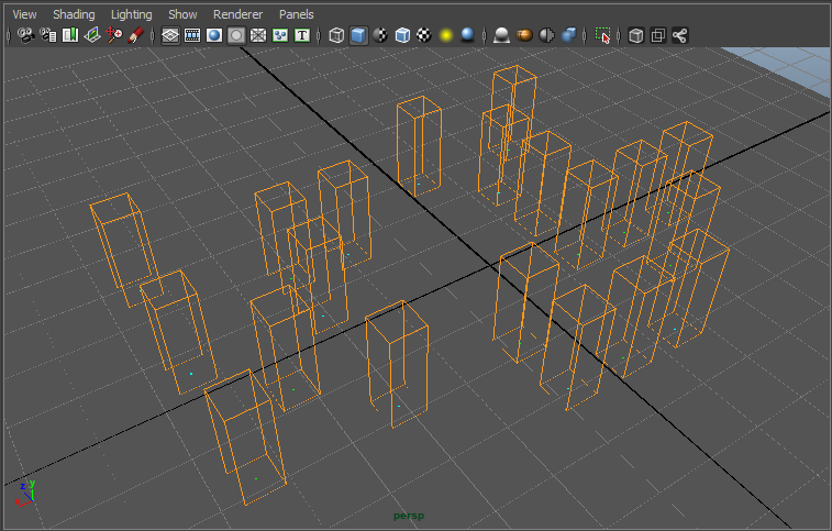

Viewport 2.0 and DirectX11
Golaem Crowd is compatible with Viewport 2.0 using OpenGL rendering. On some hardware, Maya only allows Viewport 2.0 using DX11 whether you chose OpenGL display. If the Viewport 2.0 display is DX11 entities will only be displayed with orange bounding box and an error message will appear in the console.
*Golaem with DX11 display compatibility mode.*
