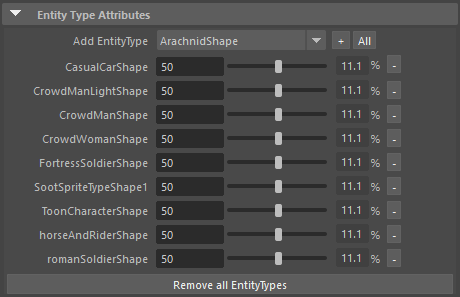

This panel defines which Entity Types will be assigned to the members of the group.
New Entity Types can be added to the Group Types by selecting them in the Add EntityType combo box and then clicking on the add button
. To add all Entity Types, click on the
button. To remove an Entity Type just click on the related remove button
. Remove all Entity Types with the Remove all EntityTypes button.
Each selected Entity Type has an attribute defining its weight relative to the other Entity Types. The ratio of Entity Types in the Group Type will be affected by changing the weight attributes.
