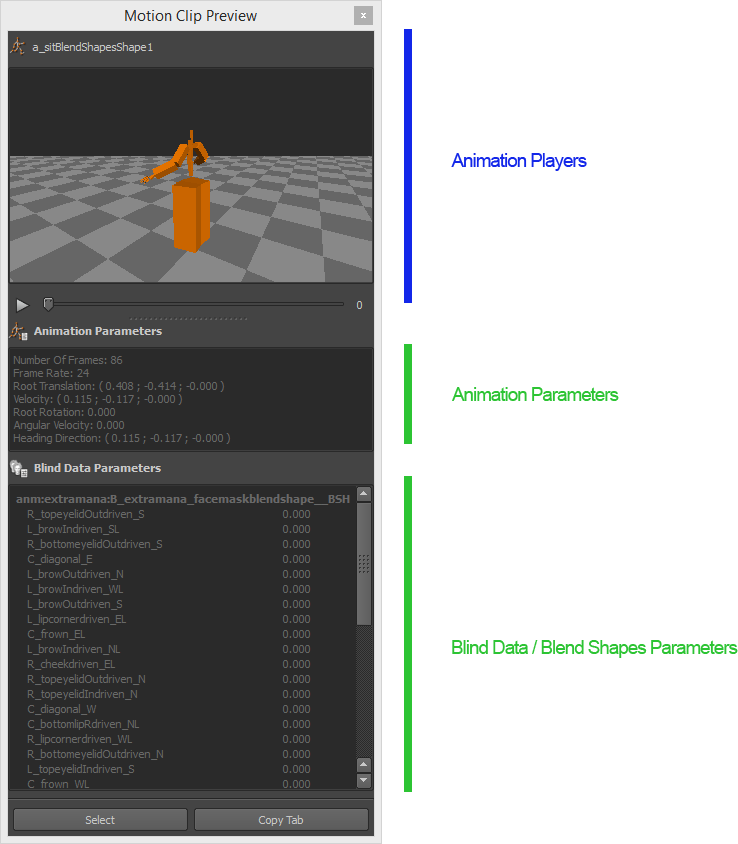

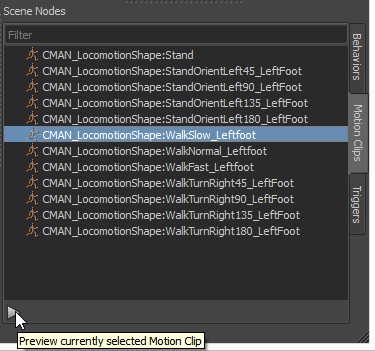

The *Motion Clip Preview *is a dockable tool dedicated to the preview of any Motion Clip currently in the scene.
*or *Ctrl +
Double-click directly on the desired Motion Clip.
The Motion Clip Preview is divided in two. The top part contains the Animation player, composed of a 3d view and a time line, the bottom part contains the animation properties and blendshapes properties (if blend shapes in the animation). The Animation player also displays footprints if there are any.
Motion Clip Preview Overview
