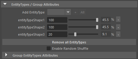

EntityTypes / Group Attributes
This panel defines which Entity Types will be assigned to the emitted particles. Notice that Entity Types previously selected in the Population Tool Context are present in this layout.
New Entity Types can be mapped by selecting them in the Add EntityType combo box and then clicking on the add button . To add all Entity Types, click on the button. To remove an Entity Type just click on the related remove button . Remove all Entity Types with the Remove all EntityTypes button.
Each selected Entity Type has an attribute defining its weight relative to other mapped Entity Types. The ratio of Entity Types in the Population Tool Locator will be affected by changing the weight attributes.
Illustration of the use of Entity Types during the placement step with different weights

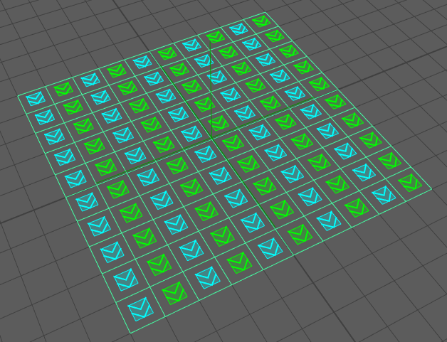

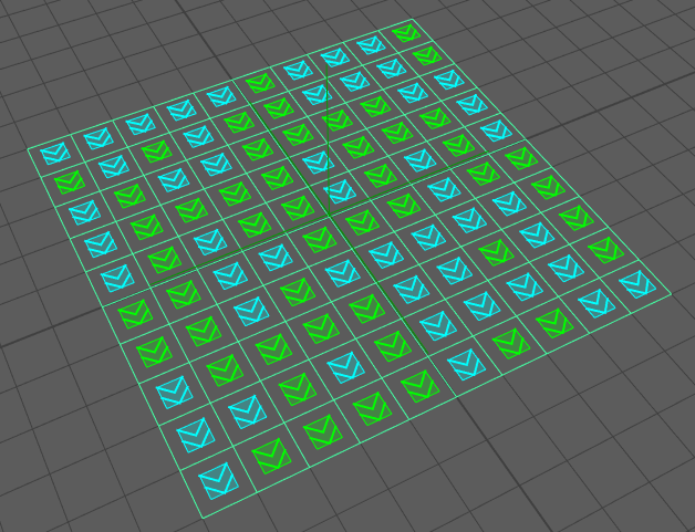

Enable random shuffle Add randomness to the Entity Type distribution. The Entity Type sequence is randomly shuffled.
Enable Random Shuffle off (left) vs Enable Random Shuffle on (right) on a face component Population Tool
