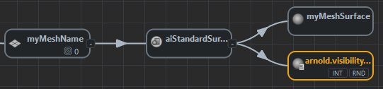

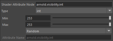

Within Arnold, render stats are all merged as an flag based integer value called visibility. To check the resulting value or disabling / enabling specific render stats, the easiest is to apply them to a Maya mesh and use the .ass exporter to check the resulting value. Then you can set this value, on a per mesh basis, using the Renderer Attributes:
Example: disable the Casts Shadows visibility flag
Casts Shadows enabled / disabled
