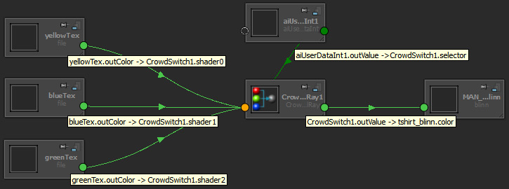

Crowd Switch Shader used in the tshirt shading graph of a crowd

This shader can be used to feed a color attribute of any other shader. The output attribute of this shader is called outValue.
In the following example the Crowd Switch Shader has 3 textures connected to its 3 first Shader slots. Its Selector value is fed by an Arnold aiUserDataInt shader and its output is connected to the Color attribute of a Blinn Tshirt shader.
At render time, Entities having this Blinn Tshirt shader listed in their Assets and a correctly defined Shader Attribute, you get the following result:
