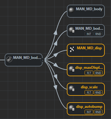

Example of a Displacement Shader applied to a Shading Group Node
Configuration
You can configure a Displacement Shader by linking to the Shading Group Node some specific Shader Attributes. Here are the supported Shader Attributes (those parameters are the same attributes defined by Redshift for each mesh in Maya):
Attribute Name Type Description
disp_maxDisplace float Maximum length the displacement shaders/textures will be displacing the vertices by (notice that this value can also be controlled with a ppAttribute).
disp_scale float Scales the displacement results, which has the effect of accentuating or toning down the displacement (notice that this value can also be controlled with a ppAttribute).
disp_autobump int Emulates what would happen if you were to tessellate your geometry to a sub-pixel level and modifies the surface normals accordingly, as if they were bump-mapped. (notice that this value can also be controlled with a ppAttribute).
Example of Shader Attributes applied to a Displacement Shader
