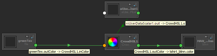

Crowd HSL Shader used in the tshirt shading graph of a crowd (variation of saturation on a texture)

This shader can be used to feed a color attribute of any other shader. The output attribute of this shader is called outColor.
In the following example the Crowd HSL Shader has a texture connected to its In Color attribute. Its Saturation attribute is fed by a RedshiftUserDataScalar aiUserData Shader shader and its output is connected to the Color attribute of a Blinn Tshirt shader.
At render time, Entities having this Blinn Tshirt shader listed in their Assets and a correctly defined Shader Attribute, you get the following result:
