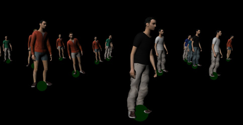

By default, Renderman Studio renders particles as spheres even if their Display Type is set to Points. Thus, when rendering Crowd Entities, particles will be rendered as well.
Default rendering of particles in Renderman Studio
