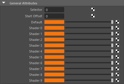

Configuration
Selector Value of the RGB input to return (if Selector has a value of 1 and Start Offset has a value of 0, Shader 1 is returned). The value of this attribute can be set and controlled per Golaem Entity through an int Shader Attribute
Start Offset Offset to apply to the Selector value before returning the corresponding RGB input (if Selector has a value of 11 and Start Offset has a value of 10, Shader 1 is returned)
Default RGB input returned if the Selector is out of range
Shader 0-9 RGB input at index 0-9
