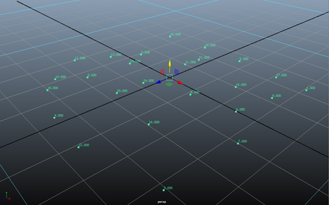

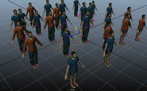

A Crowd Field is a Maya particle field which converts the connected Maya particles into Crowd Entities. The created Crowd Entities are initialized depending on the parameters specified in the Population Tool (EntityType, distance, position...). Thus, an Entity relative to a particle is enslaved to this particle: the XZ position of entity tends to match the particle one, while the Y position is defined by the Terrain and/or the behaviors). A Crowd Field also defines the attributes shared by all Entities.
Influence of a Crowd Field applied on a particle system

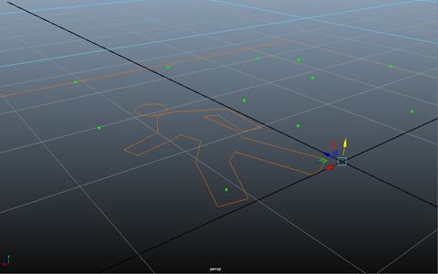

When selected, the Crowd Field display a bounding box its connected Crowd Entities.

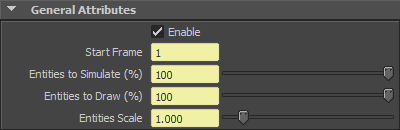

General Attributes
Enable If checked, the relative Crowd Field is enabled. If not, the connected particle systems will be neither initialized into Crowd  Entities nor animated.
Start Frame Frame from which the Entities of the Crowd Field will be initialized (must be equal or higher than the start frame of the Crowd Manager) in the scene or reinitialized each time the current time reaches the start frame. Keep in mind to change particle system's start frame accordingly too.
Entities to Simulate (%) Percentage of particles which will be initialized and animated. This parameter is mainly for debug purpose, but can prove useful by saving performance for testing computation intensive scenes (physics or heavy navigation behaviors). This attribute is connected to the Crowd Manager.
Entities to Draw (%) Percentage of simulated particles which will be drawn in Maya. Notice that, even if an Entity is not displayed, it is updated and it can be exported at each frame. This attribute is connected to the Crowd Manager.
Entities Scale Scale applied to all Entities connected to this CrowdField (default to 1). Additionally, entities can be scaled per EntityType, see EntityType. This attribute is connected to the Crowd Manager.

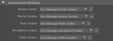

Environment Attributes
Terrain Locator Terrain Locator which is used by the simulation. It is used by Entities to adapt their feet to the ground, reach a target with a Go To Behavior and avoid other Entities with the Navigation Behavior. If two Crowd Fields are using two different Terrain Locators, their Entities will not be able to avoid each other. By default, it uses the Terrain Locator defined in the Crowd Manager.
Physics Locator Physics Locator which defines the physics environment used by the Physicalize, Force and Detach behaviors. If two Crowd Fields are using two different Physics Locator, their Entities will not be able to collide with each other. By default, it uses the Physics Locator defined in the Crowd Manager.
Flock Locator Flock Locator in which flocks can move using the Flock and Steer behaviors. If two Crowd Fields are using two different Flock Locator, their Entities will not be able to avoid each other. By default, it uses the Flock Locator defined in the Crowd Manager.
Perception Locator Perception Locator defines the perception environment of a crowd simulation. It is used by the Activate Sensor Behavior and the Navigation Behavior. All objects that can be detected by sensors are added to the perception environment. If two Crowd Fields are using two different Perception Locators, their Entities will not be able to avoid perceive each other. By default, it uses the Perception Locator defined in the Crowd Manager.
Traffic Locator Traffic Locator defines the road graph on which entities can move, using the Traffic and Traffic Goto behaviors. If two Crowd Fields are using two different  Locator, their Entities will not be able to interact with each other. By default, it uses the Traffic Locator defined in the Crowd Manager.

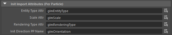

Init Import Attributes (Per Particle)
Entity Type Attr Name of the per particle or Golaem attribute containing the ID of the EntityType (between 1 and n) for each Entity.
Scale Attr Name of the per particle or Golaem attribute containing the scale for each Entity.
Rendering Type Attr Name of the per particle or Golaem attribute containing the Rendering Type index for each Entity.
Init Direction PP Name Name of the vector per particle attribute, containing the init direction of the Entities ((1, 0, 0), X-front aligned).
Several Per Particle Attributes can be defined to control the simulation more precisely. For more information on how to use Per Particle Attributes, see Per Particle Attributes Handling.
