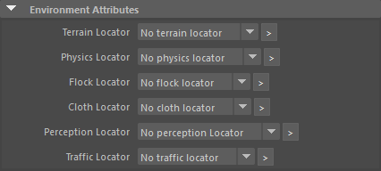

Environment Attributes
Terrain Locator Terrain Locator which is used by the simulation. It is used by Entities to adapt their feet to the ground, reach a target with a Go To Behavior and avoid other Entities with the Navigation Behavior. The Terrain Locator can be overridden in each Crowd Field if required.
Physics Locator Physics Locator which defines the physics environment used by the Physicalize, Force and Detach behaviors. The Physics Locator can be overridden in each Crowd Field if required.
Flock Locator Flock Locator in which flocks can move using the Flock and Steer behaviors. The Flock Locator can be overridden in each Crowd Field if required.
Perception Locator Perception Locator defines the perception environment of a crowd simulation. It is used by the Activate Sensor Behavior and the Navigation Behavior. All objects that can be detected by sensors are added to the perception environment. The Flock Locator can be overridden in each Crowd Field if required.
Traffic Locator Traffic Locator defines the road graph on which entities can move, using the Traffic and Traffic Goto behaviors. The Flock Locator can be overridden in each Crowd Field if required.

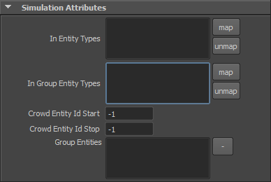

Entity Types Attributes
Simulation Attributes of the Crowd Manager node
In Entity Types Entity Types registered and available in the scene. Entity Types are automatically registered in the Crowd Manager, but you can remove/add them manually
In Group Entity Types Group Entity Types registered and available in the scene. Group Entity Types are automatically registered in the Crowd Manager, but you can remove/add them manually
Group Entities Group of Entities created in the scene, shown as [GroupId]-[GroupEntityTypeId].

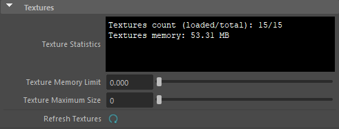

Textures
Texture Statistics Shows the number of textures that are used in GPU Previz and their memory footprint.
Texture Memory Limit Texture Memory Limit in MB (0 means no limit). After reaching this limit no further textures will be loaded.
Texture Maximum Size Texture Maximum Size in pixels, either width or height (0 means no limit). Textures with a greater width or height will be reduced before being loaded and used in GPU Previz.
Refresh Textures Reload all the textures used in GPU Previz, useful for applying changes to the texture memory or size limits.

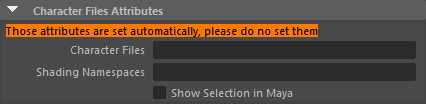

Character File Attributes
Character Files File paths to the Character Files (.gcha) separated with ";" used in the current simulation. This attribute is set automatically by the Simulation Exporter every time a simulation is cached.
Shading Namespaces Name of the Maya Namespaces to add to the to the shading assignment defined in the Geometry part of the Character files used in the current simulation (separated with ";"). There must be the same number of namespaces than Character Files. This attribute is set automatically by the Simulation Exporter every time a simulation is cached.
Blend Shape Priorities Per-blend-shape priorities used by viewport Render Previz. This value is propagated from the Entity Type settings and should not be edited directly here. For Cache Replay, the Simulation Cache Proxy Manager also exposes this attribute; configure per-proxy priorities with the editor on the Simulation Cache Proxy.
Show Selection in Maya Register the value of the Character Maker Geometry Tab "Show In Maya" attributes

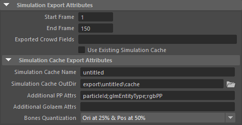

Simulation Export Attributes
Except quantization, these attributes refer to the Simulation Exporter Tool. They are automatically set by these tools and should not be modified manually.
Bones Quantization
By default, Golaem compresses the cache by computing some quantization on orientation and position. This reduces the disk size of each frame resp. to 25% and 50% of original orientation and position size.
This quantization can be configured only for orientation, for position, for both or not at all. Ratios of quantization can be 50 or 25 % for orientation, and 50% for position.
In some cases where the bones are broken by physics simulations, the position may exceed the maximum expected value for quantization and generate bad results after rereading. In that case it is recommended to only use Orientation (at 25% if possible for smaller files).
In other cases, animators may have driven their bones from far away to produce "almost translation" when rotating them. This is typically a case where orientation quantization will be more sensible, and will need to be reduced or even cancelled : a very small difference in orientation on that bones can, indeed, lead in a major position difference in the end.

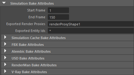

Simulation Bake Attributes
These attributes refer to the Character Maker's Geometry Tab and the Simulation Tool. They are automatically set by these tools and should not be modified manually.

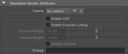

Rendering Attributes
Rendering attributes
Camera Camera used for frustum & LOD previz
Enable LOD If checked, the LOD defined in the Character File will be used. Notice that it only works in Cache Replay Mode
Enable Frustum Culling Perform a frustum culling on procedural geometry while rendering (available for Arnold, Redshift and V-Ray).
Frustum Margin/Camera Margin
Inflate the frustum and the margin around the camera. Characters inside or touching the orange frustum will be generated at render time.
Display Frustum Display the frustum previz
Dirmap The dirmap string, used to replace root of folders
Dirmap Current dirmap rules to relocate Geometry file (.fbx or .gcg) absolute paths stored in the Character Files (.gcha)

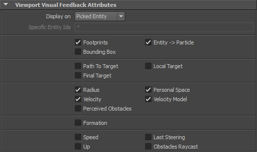

Viewport Visual Feedback Attributes
Defines the Visual Feedback displayed inside Maya Viewport.
Notice that these attributes can also be configured in the Crowd Visual Feedback under the Maya Viewport Settings panel.
Viewport Visual Feedback Attributes of the Crowd Manager
Please refer to the Crowd Visual Feedback page for parameters' details.

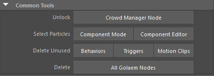

Common Tools
Unlock Crowd Manager Node A Golaem Crowd scene should have one and only one Crowd Manager. To ensure it's not inadvertently deleted, this node is locked. However sometimes when importing crowd scenes into another,  a scene can contains several Crowd Manager nodes. In such a case ones should use the "Unlock Crowd Manager Node" button to unlock unnecessary nodes before deleting them (or unlock/delete them using MEL or Python)
Select Particles
  • Component Mode: Selects the particles as components of the selected Particle Systems. If none are selected, all particles are selected as components
  • Component Editor: Opens the Component Editor for the selected Particle Systems. If none are selected, they are all in the Component Editor
Delete Unused
  • Behaviors: Deletes all the Behavior Nodes, Operators and Behavior Containers which are not used by the scene Entity Types. As the deletion process is not recursive, it may be required to press it several times to remove all unused Behaviors.
  • Triggers: Deletes all the Behavior Triggers which are not used by the scene Behavior Nodes or Operators. It is usually intended to be used once all the unused Behaviors have been deleted.
  • Motion Clips: Deletes all the Motion Clips which are not used by the scene Behavior Nodes.  It is usually intended to be used once all the unused Behaviors have been deleted.
Delete All Golaem Nodes Removes all the Golaem nodes and dependencies from the scene
