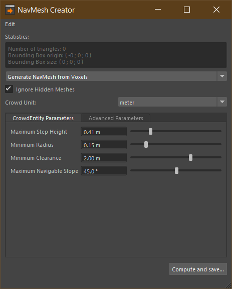

Configuration
To start using the NavMesh Creator, first select the geometry you wish to transform. You can select any mesh or group of meshes in Maya.
If no mesh is selected a warning will be displayed.
Generation Mode Dropdown
When creating a Navigation Mesh from Maya meshes, two choices are possible:
Generate Navmesh from Voxels
The first, used by default, computes voxels and accessibility links between them to determine valid navigable areas. It can be finely tweaked and is the most effective for usual grounds, those not meant to be used as a globe/mini-planet-like ground. Its main limitation is that it is Y-Up locked and cannot handle navigation around 3D objects.
Generate Navmesh from MayaMesh triangulated faces
When the need of a planet-like ground is required, then the right choice is to use this mode. It is less optimized, and is basically a brute force preparation of the navigation graph, linking all neighbor faces in the navigation graph if there is no obstacle in the way. If a face edge is navigable, each of its edges will hold a waypoint, placed as far as possible from the closest obstacle (or in the middle if no obstacle is found). The obstacles in this mode are limited to the mesh geometry inner/outer borders, there is no computation of clearance, steps, or slopes, only the radius is checked against obstacles. Its limitations is therefore a less optimized navigation graph, and no management of slopes / clearance /etc. It should only be used when navigation all around the object is required (to the opposite of Y-up locked first mode). Using this mode with a large mesh (> 20 000 vertices) will issue a warning.
Subdivision Type
The used subdivison technique creates a voxel mold that approximates the input geometry. The voxels are then used to extract contours around obstacles and around the edges of the world, which in turn are used to create the NavMesh (navigation mesh). The process uses the Recast library (see http://code.google.com/p/recastnavigation/).
This technique is very fast on most environments, especially when increasing the voxel size. On the other hand, the computed NavMesh is only a loose approximation of the input geometry (depending on the voxel size), and some details like steps will not be preserved. The computation time mostly depends on the size of the environment, and it is not influenced by the topological complexity of it (like the number of triangles, of obstacles, holes, slopes, etc.).
Statistics
The statistics panel is updated each time the geometry selection changes. It shows the total number of triangles, the bounding box origin and the bounding box size of the selected meshes.
Ignore Hidden Meshes
When checked (default), the NavMesh Creator will not take into account the meshes that are hidden in Maya.
Crowd Unit
This combo box specifies how to convert Maya's units to Crowd units (see here for more explanation). The default value of the Crowd Unit can be set by using the GLMCROWD_UNIT environment variable. The Crowd Manager also has a Crowd Unit parameter: if it is set in the manager, the value in inherited in the NavMesh Creator tool

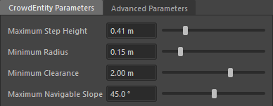

Crowd Entity Parameters
This tab contains all the Entity related parameters needed to compute the NavMesh. These parameters are available on both voxel based and exact subdivisions.
Maximum Step Height the maximum navigable step height for the simulated Entities (in Golaem meters). An object with a height exceeding this parameter will be considered an obstacle and Entities will navigate around it. This parameter cannot exceed the minimum clearance (see below).
Minimum Radius the minimum radius of the simulated Entities (in Golaem meters).
Minimum Clearance the minimum height of the simulated Entities (in Golaem meters). This parameter cannot be smaller than the maximum step height (see above).
Maximum Navigable Slope the maximum angle (in °) of a slope on which Entities will navigate on the computed NavMesh. Slopes with a higher angle will be considered obstacles.
By default, those parameters are set for regular human characters.

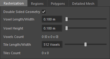

Rasterization Parameters
Double Sided Geometry Voxel based subdivision is sensitive to the orientation of the input triangles. Triangles facing down will not be taken into account unless this option is checked.
Voxel Length/Width Width and length of a voxel (in Golaem meters). Using bigger voxels reduces computing time but the computed Navmesh will also be less precise.
Voxel Height Height of a voxel (in Golaem meters). Using bigger voxels reduces computing time but the computed Navmesh will also be less precise.
Voxel Count Total number of voxels that will be generated from the input geometry, and also the number of voxels along each axis (x, y and z). The voxels count is updated when the voxel length/width, height, or input geometry change.
Tile Length/Width Large environments are divided into square tiles that can be computed individually, thus reducing the memory footprint of the computation. This parameter defines the length and width of each tile, in voxels.
Tiles Count Number of tiles along the x and the z axis. The tiles count is updated then the voxel length/width, the tile length/width or the input geometry change.

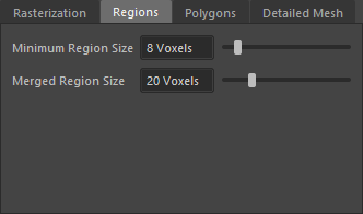

Regions Parameters
The walkable voxels are grouped together into regions, based on the obstacles detected in the environment.
Minimum Region Size This parameter defines the minimum number of interconnected voxels that are allowed to form isolated areas.
Merged Region Size Regions with a voxel count smaller than this parameter will be merged with other regions if possible.

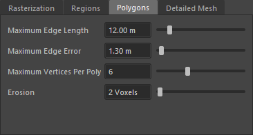

Polygons Parameters
Maximum Edge Length This parameter sets the maximum length of an edge along the borders of the NavMesh. Edges longer than this value will be split into several edges as needed.
Maximum Edge Error Raw contours are computed as limits between voxels of different regions. These contours are then simplified to reduce the number of edges in the NavMesh. This parameter sets the maximum distance a simplified contour's borders should deviate from the original raw contour.
Maximum Vertices Per Poly The maximum number of vertices allowed for polygons generated during the subdivision process.
Erosion The distance to erode/shrink the walkable area away from obstacles.

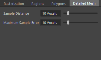

Detailed Mesh Parameters
Sample Distance The sampling distance to use when generating the detail mesh
Maximum Sample Error The maximum distance the detail mesh surface should deviate from heightfield data

Export
The NavMesh computation can be launched by using the "Compute and save…" button. Note that depending on the scene complexity, computation can take a long time and that you will not be able to use this Maya instance until it ends. You can check the computation progress in the NavMesh Creator status bar.
If the total voxel count is too big, the NavMesh creator will display a warning that the computation may take a long time. In this case, please check the Crowd Unit or increase the voxel size.
When computation is done, the process automatically creates a Terrain Locator with the exported .gse file loaded. The input geometry used to generate the NavMesh is also mapped to the Terrain Locator as ground geometry.
