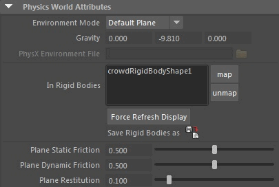

Physics World Attributes
Environment Mode
There are 3 environment modes :
  • Default Plane : use a default 0 height infinite plane as physics world
  • File : physical objects are loaded from an external file
  • None : no physical object is instanciated, but gravity is still applied.
Gravity Gravity to use for the physics environment.
PhysX Environment File (.xml file) PhysX Environment File to load and display. By default even if no file is loaded, the Physics Locator use a center plane. This file can be generated with the 'Save Rigid Bodies' button (see bellow), or from Maya with the PhysX plug-in.
In Rigid Bodies Crowd Rigid Body nodes to add the current PhysX Environment.
Force Refresh Display It may happens that the display of Crowd Rigid Bodies is not automatically refreshed. In such a case, click on this button to manually force a display refresh.
Save Rigid Bodies By clicking on this button, all rigid bodies in the 'In Rigid Bodies' list can be saved in a single file, that can later be used in the 'Environment File' attribute.
Plane Static Friction Plane static friction factor if the Environment Mode was set to Default Plane (Static friction is what happens when one object stands on the plane without moving)
Plane Dynamic Friction Plane dynamic friction factor if the Environment Mode was set to Default Plane (Dynamic friction is what happens when one object is moving on the plane: less force is needed to move the object than when it's still)
Plane Restitution Plane restitution factor if the Environment Mode was set to Default Plane

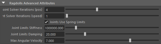

Ragdoll Advanced attributes
Joint Solver Iterations (pos) Number of iterations that helps stabilizing the joint positions
Joint Solver Iterations (speed) Number of iterations that helps stabilizing the joint orientations
Joints Use Spring Limits True to use spring limits instead of hard limits (spring limits are easier to stabilize)
Joint Limits Stiffness Stiffness of the joint limits' spring (the force proportional to the position error)
Joint Limits Damping Damping of the joint limits' spring (the force proportional to the velocity error)
Max Angular Velocity The maximum angular velocity that is allowed in physX

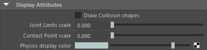

Display Attributes
Draw Collision shapes Show or hide the PhysX collision shapes. This option is only read when a simulation is initialized (this option considerably slows down the physics simulation: use it to check the PhysX simulation in case of problems).
Joint Limits scale Size of the joint limits displayed in PhysX
Contact Point scale Size of the contact points displayed in PhysX
Physics display color Color to use for the display of the physics world

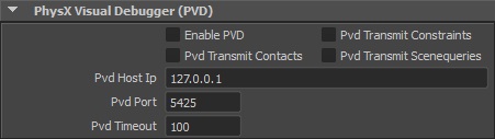

PhysX Visual Debugger Attributes
These options let you connect to the NVIDIA Physx Visual Debugger (PVD).
The Nvidia PVD is a tool provided by Nvidia to debug PhysX scenes, and can be useful when trying to understands what costs the most CPU time in a physics simulation.
Enable PVD Enable or disable the connection to the PVD
PVD Transmit Constraints Enable or disable constraint in PVD
PVD Transmit Contacts Enable or disable contacts in PVD
PVD Transmit Scene queries Enable or disable scene queries in PVD
PVD Host IP IP address of the host running PVD
PVD port PVD port on the host running PVD
PVD Timeout PVD timeout configuration

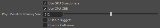

Use GPU Broadphase GPU acceleration for the collision detection part of the physX engine. This is a beta version, and only available on Windows platforms.
Use GPU GRB GPU acceleration for the rigid bodies of the phsyX engine. This is a beta version, and only available on Windows platforms.
PhysX Scratch Memory Size Increasing this value might accelerate the physics simulation on some really heavy scenes
Disable Triggers Disable collisions Triggers. This can be used to speed up simulation when collision triggers are not used in the scene
Disable Collisions Disable every collisions between ragdolls. This can be used to speed up simulation when collisions are not necessary
