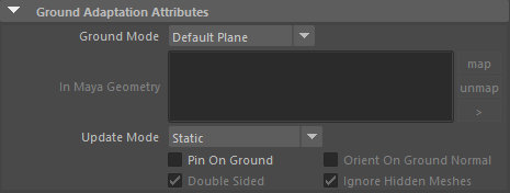

Ground Attributes
Ground Mode Ground to which the Entities will adapt during the crowd simulation. The available choices are:
  • Default Plane: the ground is considered to be an infinite plane at zero height (y = 0)
  • NavMesh Ground: the ground is the navMesh loaded from the NavMesh File attribute. This can be faster than Maya geometry but also less accurate.
  • Maya Geometry: this option lets you map any Maya geometry as ground to be used in the crowd simulation.
  • None: no ground is used
In Maya Geometry Maya polygons used as ground geometry, when the Ground Type is set to Maya Geometry.
update Mode A ground can be either static, transformed by a matrix, or dynamically deformed
  • Static: the mesh is not moved/modified during the simulation.
  • Dynamic transform: the ground is transformed (moved or rotated), but is not deformed
  • Dynamic Mesh: the ground can be transformed AND potentially deformed.
Pin On Ground If checked, the entities displacement will be adapted toward the terrain geometry. Alone, it impacts mainly the navigation part.
Orient On Ground Normal If using Pin On Ground, also change the entity normal so that playing a walk movement will walk all around a sphere for example.
Double Sided If checked, all the mapped geometry will be used as ground geometry, otherwise only the geometry facing up will be used.
Ignore hidden meshes Should the hidden meshes be used or ignored for this ground.

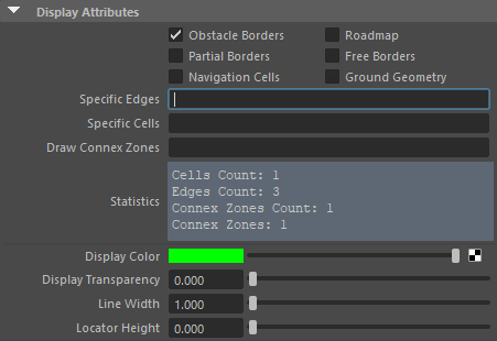

Display Attributes
Obstacle Borders (red lines)
If checked the locator displays the obstacles in the environment. If no NavMesh file is loaded nothing is displayed.
When a terrain locator with a NavMesh is used with the Population Tool or with the GoTo Behavior and the Navigation Behavior, the zones surrounded by obstacle borders are not accessible by Entities
Roadmap (orange lines) graph linking all the accessible areas in the environment. If an area or a corridor is not covered by the roadmap, it means that it is not accessible.
Partial Borders (blue lines) these are special constraints in the navMesh. They can be crossed by Entities
Free Borders (grey lines) these are all the other edges in the navMesh that can be crossed by Entities
Navigation Cells (green lines and triangles) all the walkable cells of a navigation mesh. If Draw Connex Zones (see below) is not empty, only the cells in the given connex zones are drawn
Ground Geometry (dark grey lines and triangles) the input ground geometry
Specific Edges Draws the specified edges. To specify multiple ids, use "-" for a range and "," for multiple ids or ranges (ex: 0-3,6-8,11,12). The available ids are shown in the Statistics below (0 to Edges Count-1)
Specific Cells Draws the specified cells. To specify multiple ids, use "-" for a range and "," for multiple ids or ranges (ex: 0-3,6-8,11,12). The available ids are shown in the Statistics below (0 to Cells Count-1)
Draw Connex Zones Draws only the cells belonging to the specified Connex Zones when Navigation Cells is checked. To specify multiple ids, use "-" for a range and "," for multiple ids or ranges (ex: 0-3,6-8,11,12). The available ids are shown in the Statistics below (Connex Zones). There can be than one Connex Zones only if "Keep Only Greatest Connex Zone" is unchecked in the Navmesh Creator.
Statistics
Shows navmesh statistics:
  • Cells Count
  • Edges Count
  • Connex Zones Count
  • Connex Zones
Display Color Main color of the Terrain Locator
Line Width width of the lines drawn by the Terrain Locator
Locator Height height difference to add to the lines drawn by the Terrain Locator

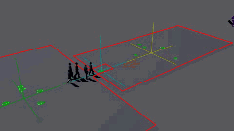

Animating a Terrain Locator
You can parent a Terrain Locator to animate it. Golaem handles parenting the TerrainLocator, and its Maya mesh used as ground, in a parent group, and animate them. The NavigationMesh will be transformed accordingly, allowing to compute a complex terrain in voxel mode (see NavMesh Creator) and transform it afterward.
It is then possible to simulate people boarding on a boat/train, which later goes away. It can be achieved by using a SetTerrain Behavior, a still Terrain Locator, and another one which can be animated (the boat / train / etc). Of course, There has to be some overlapping geometry between the two terrain locators, or a third Terrain Locator overlapping both, to allow a smooth transitioning between the terrains (those can be made of hidden geometry if needed). The train / boat Terrain Locator would require at least a "pin to ground" to move their passengers.
