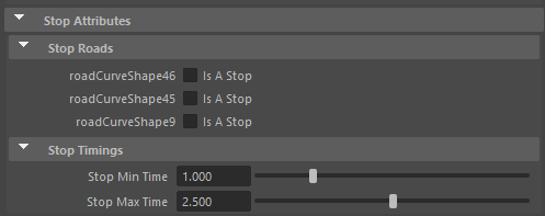

Stop Attributes
For stop crossings, each lane can be determined as the prioritary ones or one with a stop sign.
Stop Roads
Each road will appear with a checkbox allowing to select if it is a stop or not
Stop Timings
Each car will mark a pause at the stop, considered to be the time to acquire information before leaving it, which can range from [stop min time] to [stop max time] seconds.
Stop Min Time The minimal time a vehicle will stop before leaving the stop.
Stop Max Time The maximal time a vehicle will stop before leaving the stop (if no vehicle is preventing from leaving the stop).
