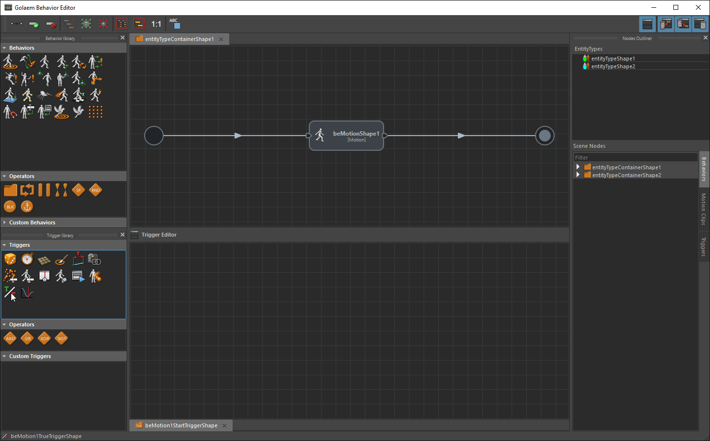

Workspace manipulations
Drag the workspace with ALT+middle-click |
Zoom in/out with mouse wheel or ALT+right-click |
Frame the workspace to all Triggers/Trigger Operators of the current opened Trigger Container |
Frame Triggers/Trigger Operators selection of the current opened Trigger Container |
Resize the workspace to the real size |

Add a Trigger/Trigger Operator into the Trigger Graph
- Drag-and-drop the desired Trigger/Trigger Operator from the
Trigger Library into the workspace. A new Trigger/Trigger Operator
will be created
Drag and Drop a Trigger into the workspace
- Press "TAB" key inside the workspace and use the hotbox. A new
Trigger/Trigger Operator will be created
Creating a Trigger/Operator with the hotbox
- Drag-and-drop a previously created Trigger/Trigger Operator from
the Trigger Outliner inside the workspace.

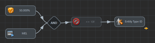

Triggers/Trigger OPERATORS Sequence MANIPULATIONS
Link Triggers/Trigger Operators
- Use the link
button
to
draw a link between Triggers/Trigger Operators
- Drag the mouse while holding the mouse middle-button in order to draw
- Drag-and-drop a Triggers/Trigger Operator to insert it in the
middle of an existing link
Unlink Triggers/Trigger Operators
- Drag-and-drop with *ALT+mouse-left *desired Triggers/Trigger
Operators out of the link
- Use ALT+mouse-left and drag to draw a
razor
Release to cut links
- Use "Unlink" in the Trigger/Trigger Operator context menu
