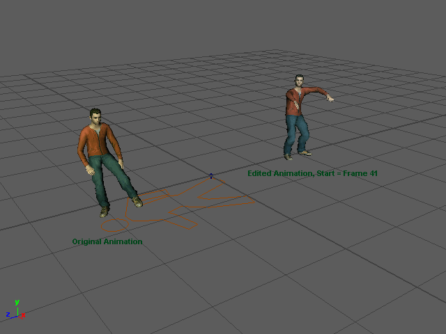

Crop an animation
Check the "Crop Motion" checkbox and fill in the Start / Stop Frame.
Obviously Stop frame needs to be greater than Start frame.
This is very useful when you want to use only a part of a Motion and do not want to spend time editing it in the character maker.
For example you can take only the "Wave arms" part of a sit-to-wave motion.
Same animation played with different Motion Clip parameters ( right:
crop start = 41, crop end = 200)

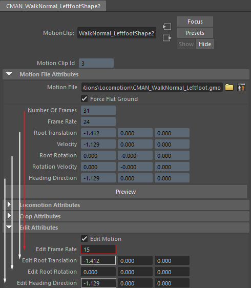

Using the Editing Motions attributes
The Motion Clip edits in this page are a bit extreme for illustration purposes, and as you can see they can affect the final animation quality. Usually the will be used only for a small correction. Also note that the same parameters can be found in the CharacterMaker when importing a motion, with the added advantage that the CharacterMaker has some Blend Attributes which enable to choose where to affect the motion and to ensure it loops.
When using these attributes, you should take care not only editing the attribute you are interested in, but also the ones you do not want to change. These values should be filled with their original values from above.
Example of how to change the Frame Rate for a particular motion clip.
Other values were copy pasted from above (note that depending on the
animation, more values may need to be copy/pasted)

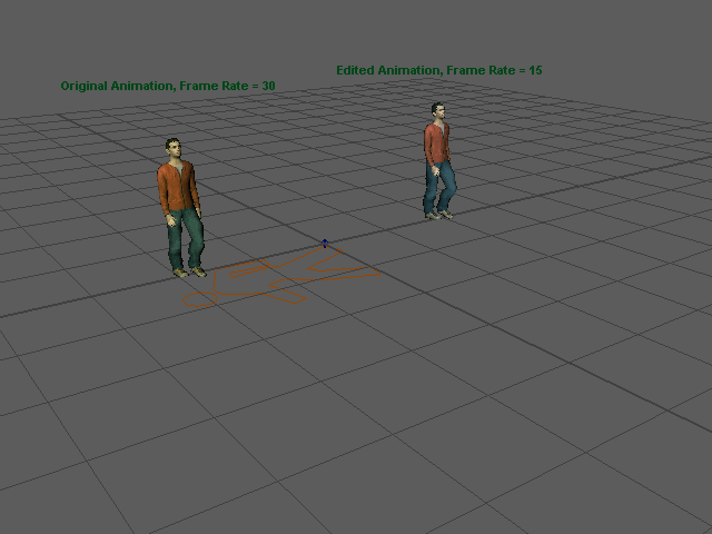

Speeding Up / Slowing Down an animation
The Frame Rate attribute can be used to change the replay speed of an animation.
Note that the same effect can be achieved by using the Speed Ratio attributes on a Motion Behavior, or the Ratio attribute on Locomotion Behavior.
Of course if the replay ratio is very high or very low, it can generate an unrealistic animation, but it is sometime the needed effect.
Same animation played with different Motion Clip parameters (left:
frame rate = 30fps, right: frame rate = 15fps)

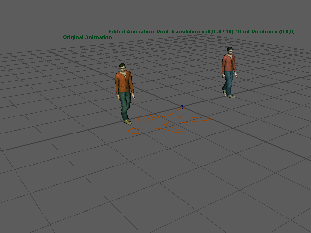

Making an animation go straight, or be replayed in-place
If an animation is not going exactly straight, or if you want to replay it in-place, or artificially go up or down (with no ground adaptation), you can edit the Root Translation (and usually also the Root Rotation, see below)

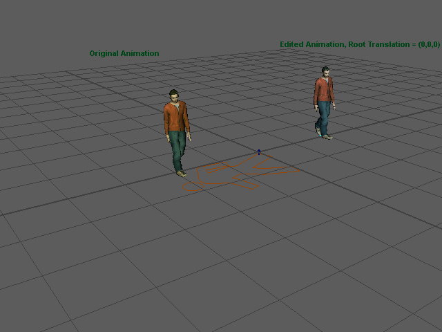

Same animation played with different Motion Clip parameters (left: root
translation = (0.736, 0, -0.936), right: root translation = (0, 0, 0))

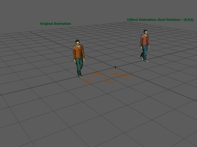

rotation = (-41.793, 2.371, -1.968), right: root rotation = (0, 0, 0))
Same animation played with different Motion Clip parameters *
*left: root translation = (0.736, 0, -0.936), root rotation = (-41.793,
2.371, -1.968)
right: root translation = (0, 0, -0.936), root rotation = (0, 0, 0)

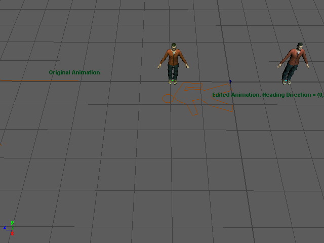

Dealing with animations which root is not oriented in the same direction as the overall motion direction (strafe...)
In most cases, the root is aligned with the overall motion direction. However sometimes you can have an animation where the root will be oriented differently.
In these cases, you can edit the heading direction to help Golaem move your character in the right direction.
This will only work with the Locomotion Behavior.
character is following a 45 degree direction, right: we fixed the
heading direction to be Z-only (0, 0, -1) and the character is following
its particle closely)
