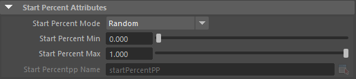

All Motions related behaviors have Start Percent Min / Max attributes. These attributes enable to choose which part of the animation a Motion Behavior will start playing. By default, Start Percent Min/Max are equal to 0, which means the animation will be played from the beginning.
However if you set Start Percent Min to 0, and Start Percent Max to 1, each character will pick a random timing in the animation to start playing. It means that instead of all playing the same animation at the same time, your characters will play different parts of your animation at a given time.
More details about Start Percent Attributes
A motion configured to start randomly between 0% and 100%

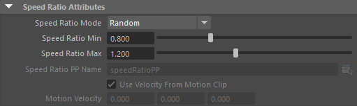

Speed Ratio Min/Max
These attributes enable to randomize the replay speed of your motions. Obviously if applied on walk animations, or if a too big / too small ratio is applied, you could end up with unrealistic animation. However, applying a small ratio range on a stadium audience motion for example can give you a bit of extra variety for a negligible cost.
By default, the speed ratio is equal to 1, which means the animation will be replayed at its original speed
More details about Speed Ratio Attributes
A motion configured to be replayed between 0.8x and 1.2x its original speed

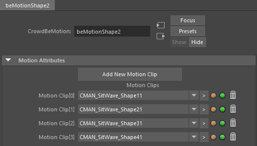

Motion Behavior
A Motion Behavior can be configured with several motions at once. At runtime (and each time the Motion Behavior is restarted), it will choose an motion in the list and play it. It makes it very easy to load various styles for a given animation.
To load several motions at the same time, just double-click on the Motion Behavior in the Behavior Editor, and select the needed files from the file explorer.
Note: if some of your motions need different parameters than the others, then it is better to use multiple Motion Behaviors linked together with a Random Operator (see below).
4 styles of Sit-to-Wave motions loaded in the same Motion Behavior

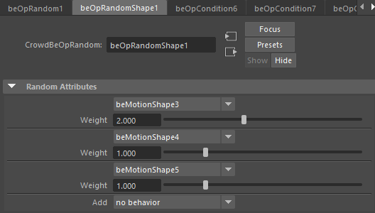

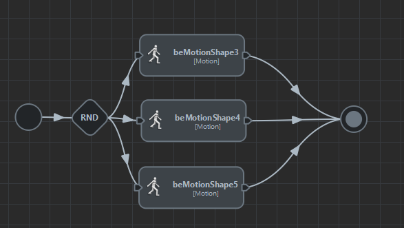

In cases where several motions cannot be loaded in the same Motion Behaviors, to choose different weights between motions, or just to make the randomization more obvious in the Behavior Graph, you can link multiple Motion Behaviors to a Random Operator.
A Motion Behavior will be chosen randomly for each character
You can change weights in the Random Operator Attribute Editor in order to have a motion played more often than others
Here beMotionShape3 will have a 50% probability to be played [ 2 / (2+1+1) = 0.5 ]
