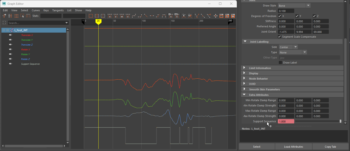

To be able to use a support sequence from an attribute in a Motion Clip or a Motion Skeleton Mapping, one first needs to save the support sequence in the desired property.
In Maya, the support sequence property needs to be an attribute on the
foot bone (the end of the Golaem leg Ik chain).
To add an attribute on a Maya bone, open the attribute editor, click in
the Attributes menu and Add
Attributes:
Add an attribute in the Attribute Editor
Once the attribute created and named, keys can be added on it. Any key with a value >0.5 will be considered as a frame where the given foot is in ground support, and any keyframe with a frame value <0.5 will be considered as not in support:
Animating the ground support sequence
Once the ground supportsequence is added to and exported in the fbx file, the support sequence can be used by Golaem by correctly configuring the Support Property Name.
Note that the property name needs to be the same for all the legs.
