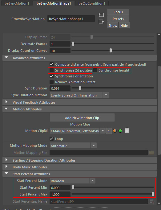

4/ We want to synchronize only the orientation of the animation, not the position of our characters. We want them to run from where they were placed and keep ground adaptation. So just uncheck "Synchronize 2d position" and "Synchronize height" on the Advanced Attributes at the top of the Behavior.
You should also increase the Start Percent Max to 1, in order to randomize the point in the animation where each character will start.

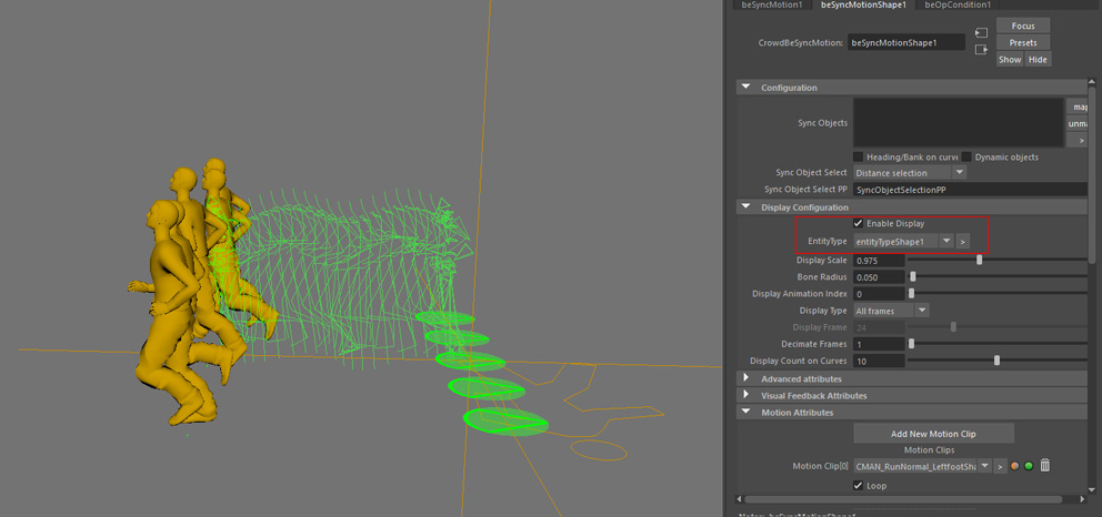

5/ Check if the synchronized motion is played with the right orientation related to your character starting orientation. Either play the simulation, or use the SyncMotion Behavior display attributes to display a wireframe view of your motion (your need to choose and EntityType).
In our case, the Motion is playing -X front, and we want our character to go X front.

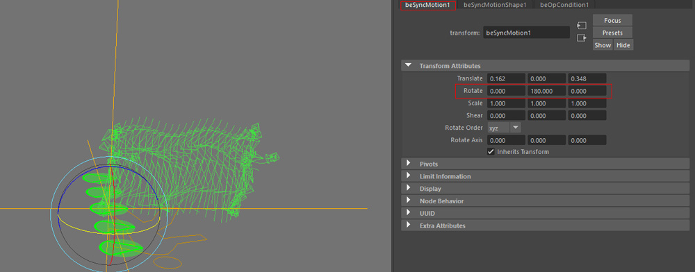

6/ To easily change the orientation of your characters, we need to map a locator to it as a reference, and then rotate the SyncMotion Behavior as needed.
For example, you could map the Population Tool, or create a usual Maya Locator. Select the locator in the Outliner, the holding the Shift key, select the SyncMotion Behavior and click map in the Configuration panel.
Then select the SyncMotion Behavior in your viewport (the green locator showing how the motion will be played), and rotate it as needed.
Note: you could just rotate the mapped locator as well, but in this simple case, it is more user friendly to orient the SyncMotion.
