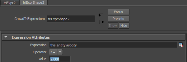

Let's see how we can start a behavior only if the velocity magnitude is greater than 0.5:
  • Double-Click on the Start Trigger in the Behavior Editor
  • Add an Expression Trigger
  • Right-click on it, as choose "set as root"
  • In the attribute editor
    • Enter this.entityVelocity in the expression field
    • Set the wanted operator
    • Enter the value to which you want to compare the speed of your character (beware of units)
