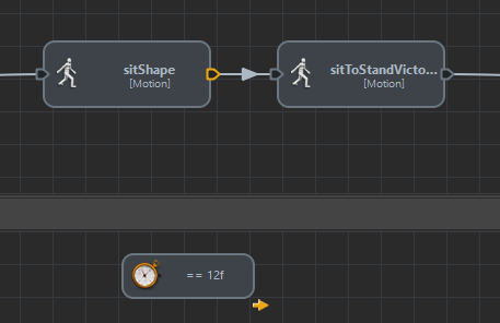

1. Place the first Motion Behavior and double-click on it to load a .gmo file
2. Drag and drop a second Motion Behavior on the arrow just after the first behavior, and double-click on it to load your other .gmo file
Caution:
Do not forget to set a Stop Trigger on your first motion, otherwise it will loop or play its last frame infinitely (depending if its loop attribute is checked or not). See steps 3 and 4 below
3. Double-click on the little arrow at the right of the first motion and drag and drop a trigger from the trigger library (here we use a Frame trigger)
4. Configure your trigger from the Maya Attribute Editor (here we say we want the Stop Trigger to be activated at frame 12)
Sequence between a sit motion and a sit-to-stand motion. A Stop Trigger is set on the sit motion to let transition happen (here at frame 12)

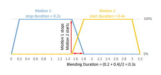

A simple transition will always start when the first motion Stop Trigger is activated (provided the second motion Start Trigger is true). To choose exactly when the transition will happen regardless of when the Stop Trigger is activated, you need to use a Custom Transition

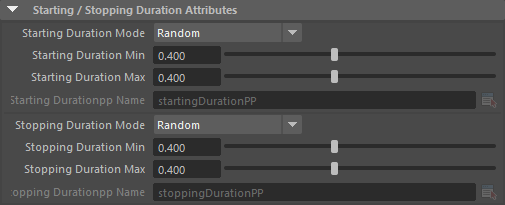

However the blending duration can be customized using each Motion Behavior Starting/Stopping Duration attributes
The blending duration is ( Motion 1 stop duration + Motion 2 start duration) / 2
For example:
