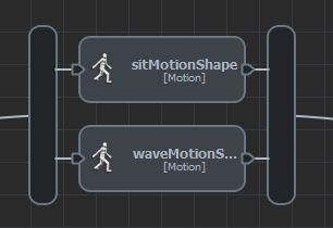

Using Parallel Operator and Body Masks on Motion Behaviors it is possible to mix motions on different parts of the body.

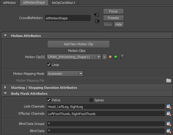

Sit Motion

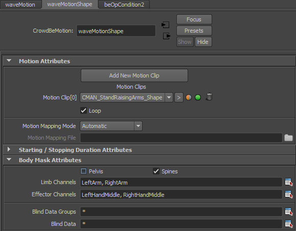

Wave Motion
We can set body masks on each Motion Behavior to replay
Here is the result of this setup on each motions
Sit Motion with body mask Wave Motion with body mask
When both Motion Behavior are in the same Parallel Operator, they replay their own animation on the unmasked body parts
Which gives the following result:
