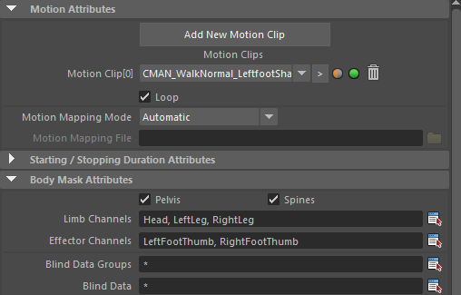

Mixing motions on different body parts
With body masks, several motions can be played at the same time on different parts of the body. When doing this there is no real blending, each animation behavior is controlling its own body parts.
A MotionBehavior playing a Walk animation on all parts of the body except the Arms. They can be controlled by another Behavior (wave hand...)
