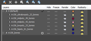

1. The character meshes are stored in their own layers, which are given the same name as the mesh. Maya will artificially rename the mesh when loading the FBX which will be complicating the asset management step. The best way to avoid it, is to put each mesh in the default layer, and delete the source layers.
The final layers arrangement

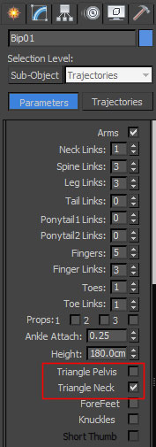

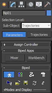

2. It is recommended to change the structure of your skeleton in order to be more Golaem-compliant. Select the root of your biped and go to structure mode by clicking on the little character in the Biped Panel
3. In the Parameters below, uncheck Triangle Pelvis, and check Triangle Neck

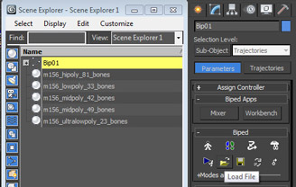

4. Optionally, you may want to load an animation and export it as well. Just select the root of the character and load a .bip file
Loading a Bip animation file

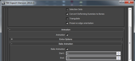

5. Export the character as a FBX file. If you need to keep animation, do not forget to check "Bake Animation" in the final export dialog.
As fbx may modify the names of your assets , check the box use scene name to avoid further problems.

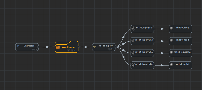

3. Drag and drop an Asset Group node before the Mesh Asset nodes and link them. Link the Character node to the Asset Group.

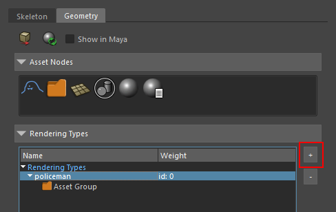

4. Go into the Rendering Types section and click "+" to create a rendering type. name it after your character (e.g. policeman)

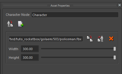

6. Click the Export Geometry File Button  and edit the bounding box of your character.

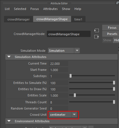

However as Rocketbox characters are built using meters (instead of centimeters, which is the default Golaem Crowd scale), you will probably need to scale them.
9. To work with the correct scale go into the Crowd Manager attributes and change the scale to centimeter. You will have to delete your poptool and create a new one.
The Crowd Manager attributes
