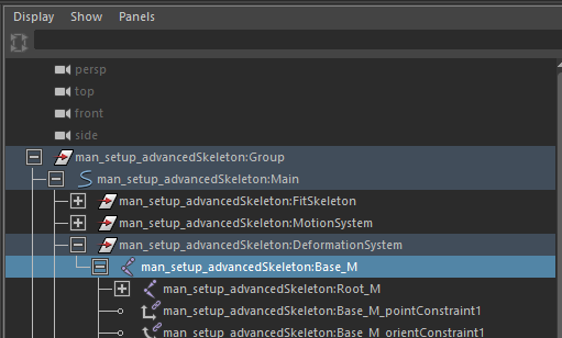

1.Open the Golaem Character Maker . Select the root bone *Base_M (not the fit skeleton one!),

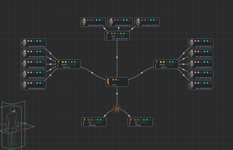

Click on Load Selected Skeleton and click Automatic Compute...
Here is what you get:

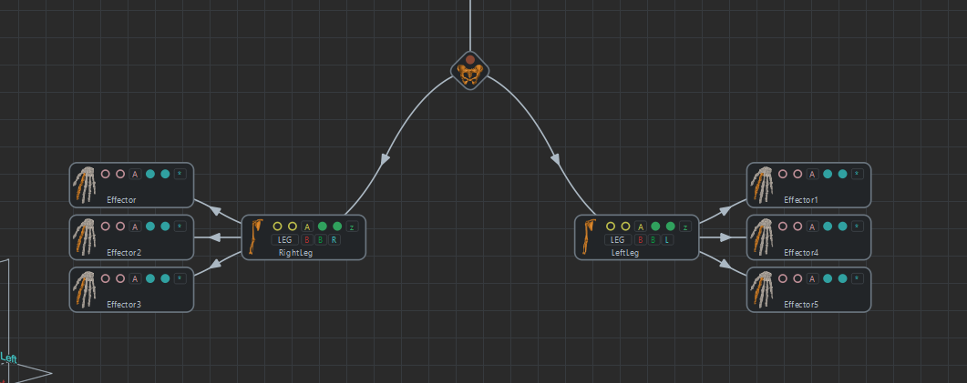

2. Drag and drop some Effector nodes and connect them to the Leg ones to map the missing bones of the feet.

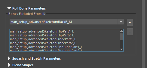

3. Now when when clicking Check Skeleton Mapping button you see that there are undesired bones in the IK of the right leg.
You can map the unwanted bones in the Roll Bone Parameters box
Your character's leg is now correct.

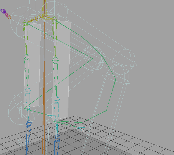

4. The Neck bone is mapped instead of the Head, just replace it.

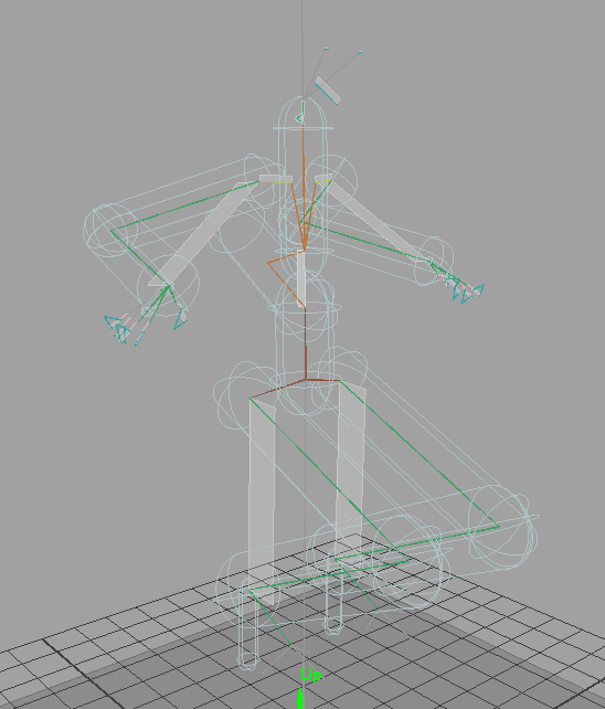

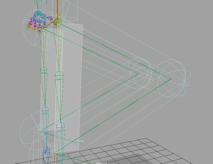

5. Once every bones are mapped click on Check Skeleton Mapping. If the Character Maker Locator doesn't bend in a good way check your IK planes normals.
