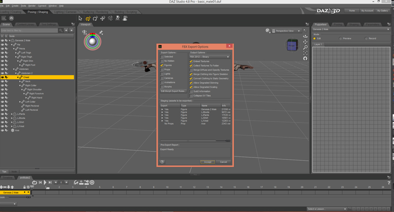

EXPORTING FROM DAZ

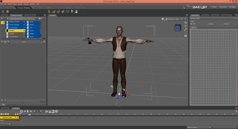

1. Create your character in DAZ studio pro.​
2. Export it as an FBX with these options enabled: Embed Textures, Collect Textures to Folder, Merge Clothing into figure Skeleton, Convert Clothing into static Geometry.

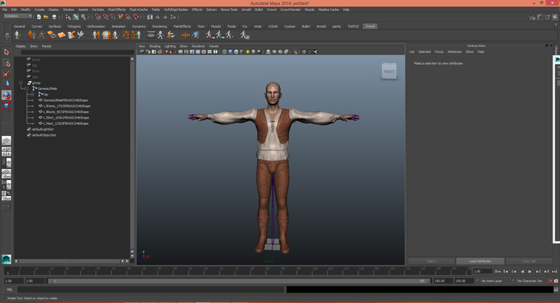

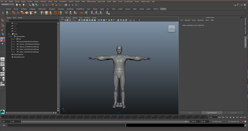

3. Open Maya, set it to centimeter if it's not the case and import your fbx.

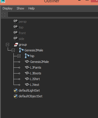

4. Rename your geometries with more nicer names.

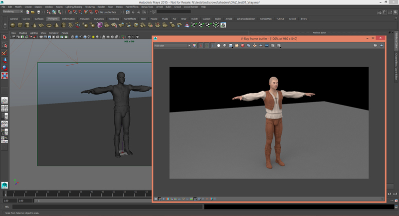

6. Check your textures, with the options you've activated your character have already some textures applied.
7. ...Yet the shaders have all been converted to Phong while exported in fbx. Convert it to your will for your favorite render engine. In this case we will use vray.
8. Test your shaders.

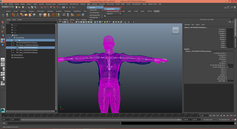

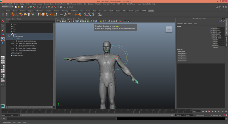

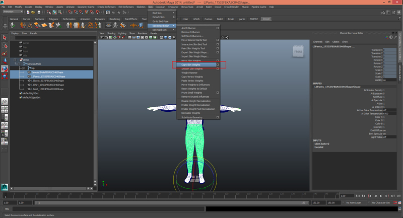

9. According to the options you've activated your character should be already skinned. But not clothes. Select your bones hierarchy and your clothes geometries and Smooth Bind.
10. Now select the already skinned body then the clothes and click copy Skin Weights.
11. Test your skinning, it should be Alright.
11. As Golaem doesn't support Segment Scale Compensate on bones please disable it on each joints, you may use this script:

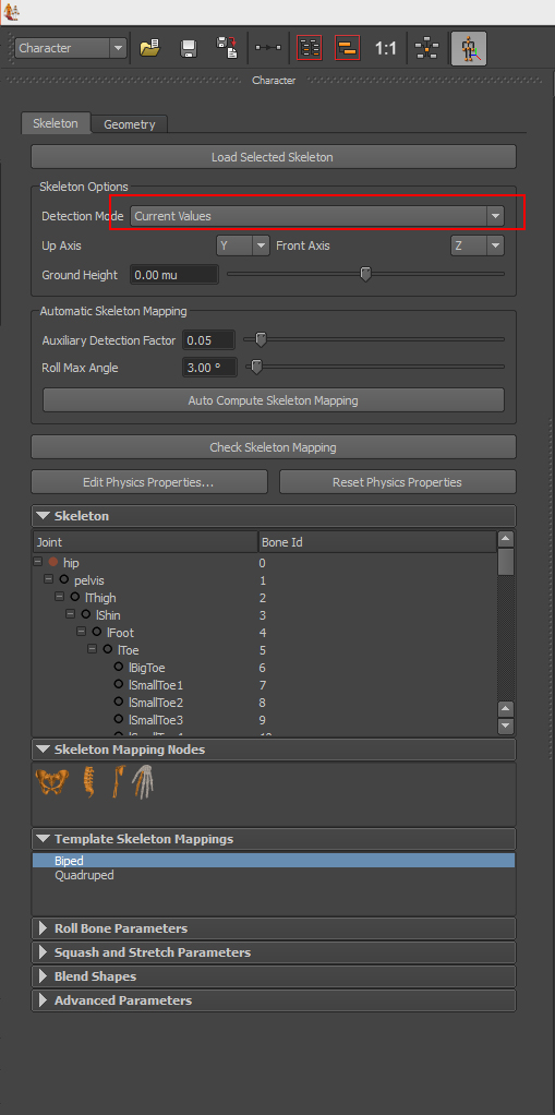

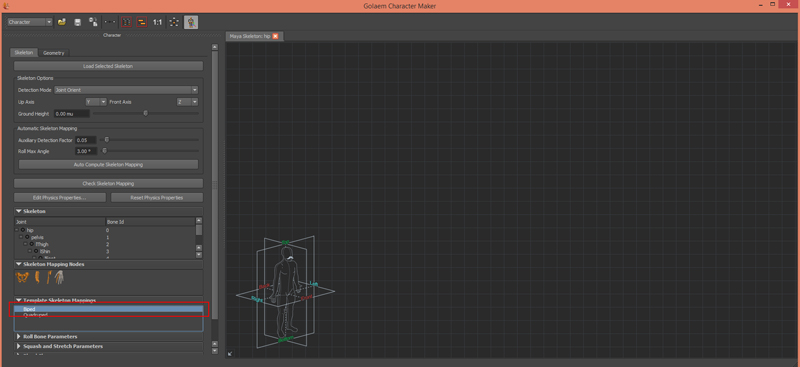

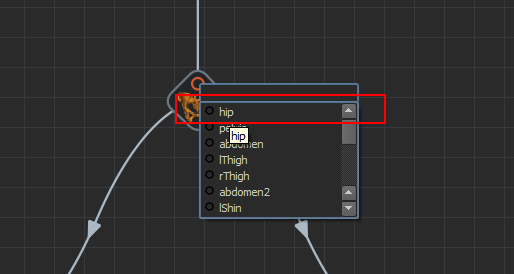

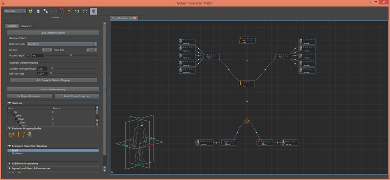

1. Now open the Golaem Character Maker . select the root bone (Hip), click on Load Selected Skeleton and click Automatic Compute... It wont work correctly.
2. Close your Golaem character file without saving it. Select your root bone again, click on Load Selected Skeleton but this time drag and drop The template Biped.
3. Hide you geometry and set the detection mode to Current Values.
Your Character Maker Locator should almost fit.

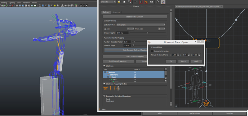

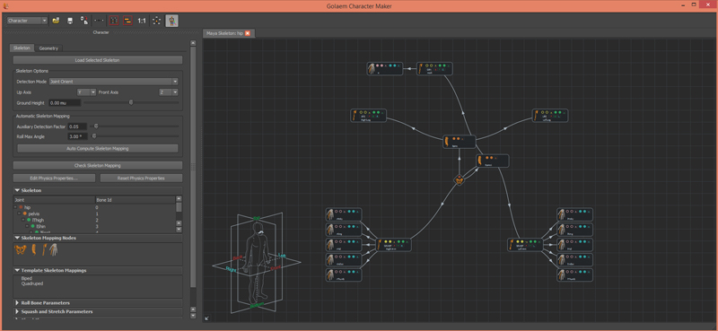

4. You will have to make all connections by hand.

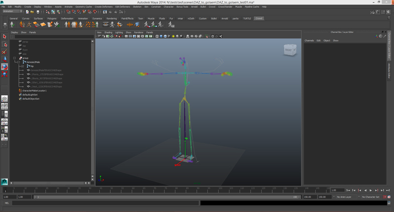

5. Once every bones are mapped click on Check Skeleton Mapping. If the Character Maker Locator doesn't bend in a good way check your IK planes normals.

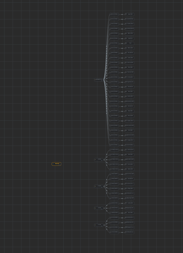

1. Open the Character Maker's Geometry Tab and select your character's geometry in the Outliner.
2. Click on the Import Geometry button  , this will load the geometry and shading nodes of your character.

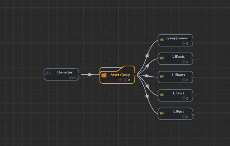

3. Drag and drop an Asset Group node before the Mesh Asset nodes and link them. Link the Character node to the Asset Group.

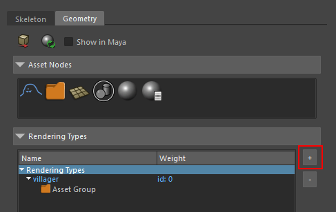

4. Go into the Rendering Types section and click "+" to create a rendering type. name it after your character (e.g. villager)
