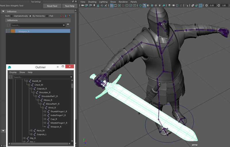

For example in the below soldier, instead of being influenced by all fingers or multiple bones of the hand, the sword is influenced only by one bone called Weapon_R. It will then be automatically instanciated (and anyway it makes it easier to control).

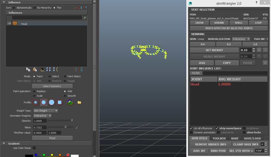

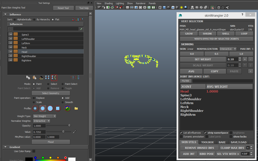

Note that it is not enough that only one bone has a non-zero weight, what is taken into account is the number of bones influencing a mesh (even if other weights is 0). For example, here only the head has a non-zero weight, as shown by clicking on the "Show influences on selected vertex" button. You can see it even more clearly by using this very useful tool which is SkinWrangler (video tutorial here)
However, because several other bones are in the influences list, auto-instancing will not be activated, which is a shame...
To clean influences, select the mesh and the skeleton root bone and then go into the Maya Menu / Skin / Remove unused influences. With this new setup, auto-instancing will be triggered.
