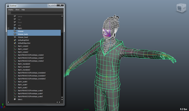

1) Duplicate (Ctrl+D) your character geometry twice. By using the regular Duplicate Tool, the skinning is lost on the copied geometry. Rename your geometries to Woman_head and Woman_body.

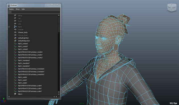

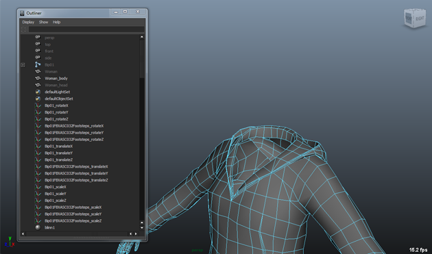

2) Hide Woman & Woman_Head. Go in Face Select Mode (F11), select Woman_Body and remove all the faces which belong to the head and torso. Process the same way with Woman_Head

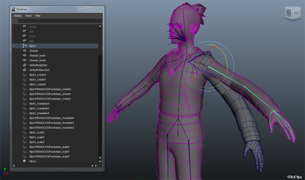

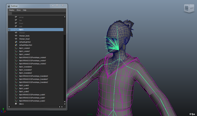

4) First, we need to specify that the two meshes (Woman_Head & Woman_Body) are skin cluster. First select your skeleton hierarchy root joint , then select Woman_Body and go to the Animation Menu ⇒ Skin ⇒ Bind Skin ⇒ Smooth Bind. When selecting the skeleton root, your mesh now appears in pink. Proceed the same way with Woman_Head.
5) Last step but not least, apply the exact skinning weight we had on our original geometry. First select the hidden mesh Woman, then select Woman_Body and go to the Animation Menu ⇒ Skin ⇒ Edit Smooth Skin ⇒ Copy Skin Weights Advanced Menu ⇒ Chose the following options. Proceed the same way with with Woman_Head.
