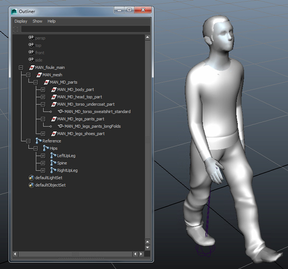

Importing animation in Maya
Import your animation in Maya.

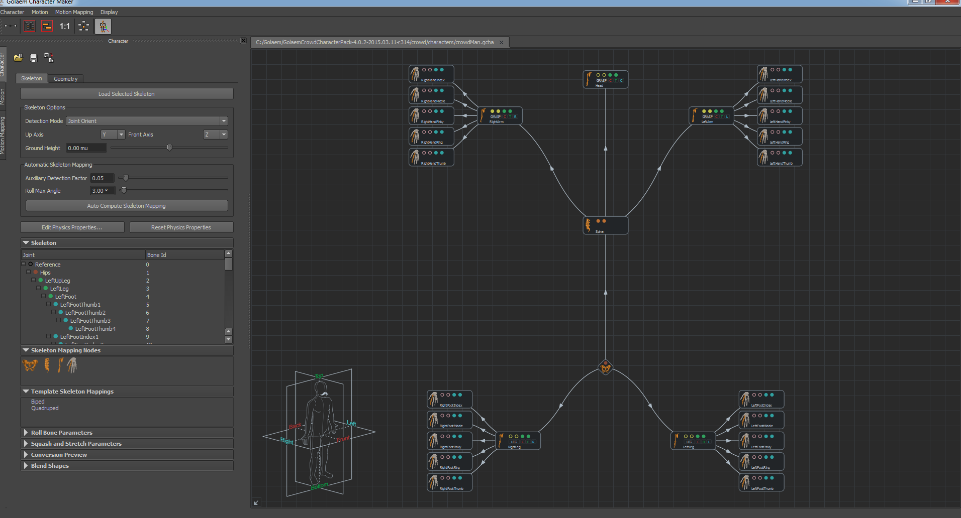

Loading a skeleton to import the animation on
Open the Character Maker .
First you need to load () a character to import the motion on.
Make sure that the loaded character is using the same skeleton as the animation to import from Maya.

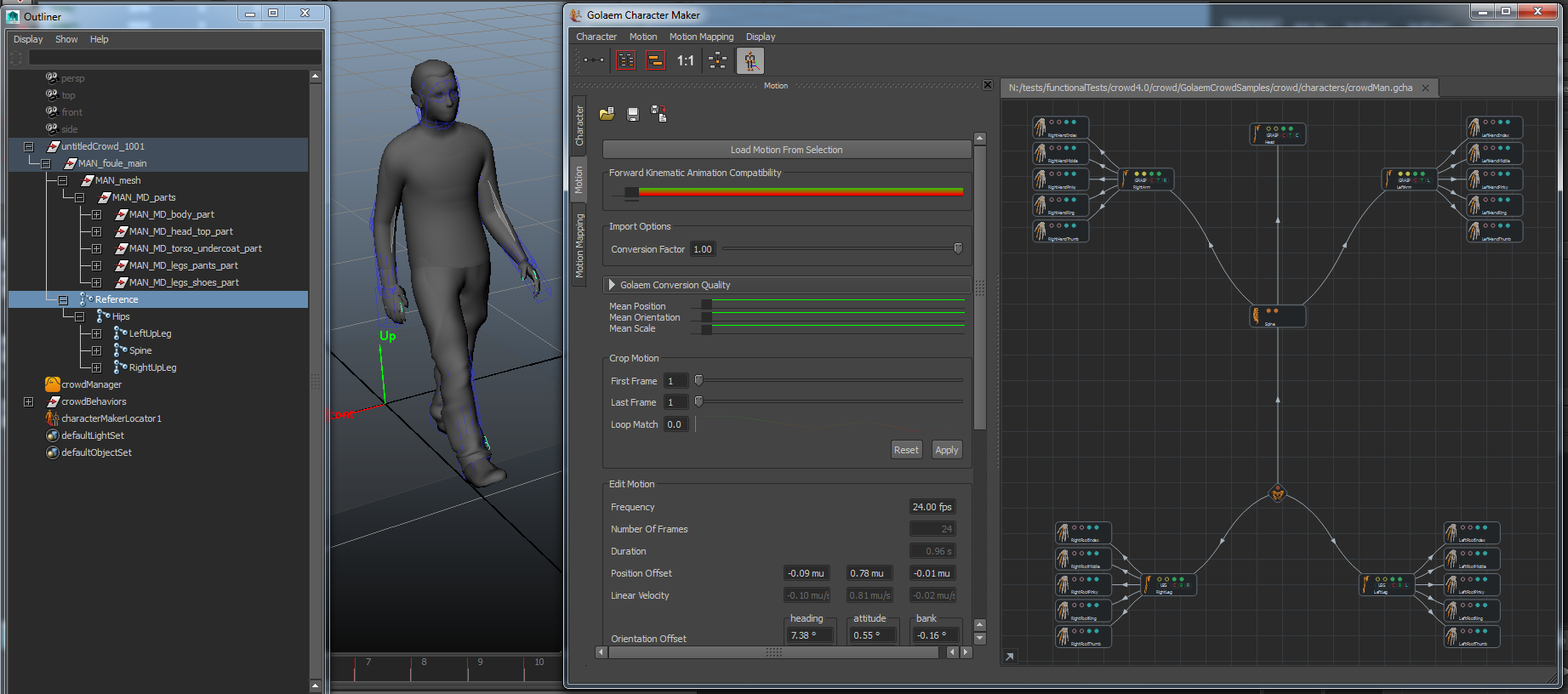

Loading the motion
Next go to the Motion Tab. Select the root of the character, and click on the Load Motion From Selection button. You can see that the Character Maker Locator now plays your animation.
If both Forward Cinematic Animation Compatibility and Golaem Conversion Quality are green, and the Character Maker Locator closely follows your animation when you play it, you can proceed to the next step. Otherwise, see the explanation about their meaning.
If the animation is not converted correctly, it may be due to:
Editing the loaded motion
At this point, you can crop your motion, or edit it or make it loop.
If the animation is to be used in a Locomotion Behavior, it is advised to make sure it is looping perfectly. The Character Maker Locator has an option to play the motion in loop to ensure it's working correctly.

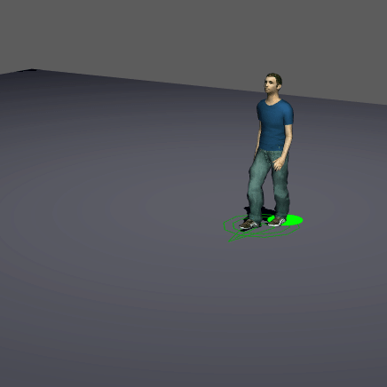

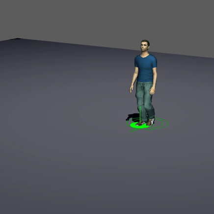

The last step, but it is a very important one, is to compute footprints for your motion. If your motion footprints are not computed correctly, it may lead to bad ground adaptation and floating characters...
The difference between correct / incorrect footprints concerning Ground Adaptation
The difference between correct / incorrect footprints in a Locomotion Behavior
