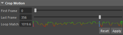

After importing the whole animation, the Crop Motion panel will display a curve showing how a given frame match with others.
The green/higher the curve, the better the frames match. You can also check the Loop match value at the left hand side of the curve to check which value is best.
Move the first frame slider to check how other frames match with the
frame you select.
Then move the last frame slider and check the values of the higher
points of the curve to find the best match (the lower the value, the
best match it is. 0 is a perfectly looping motion).
Note that depending on the number of frames, when you move the sliders they may move two (or more) frames by two frames. In this case you can click in the first or last frame input field, and change values using arrow keys, to get the best possible frame.
When you found the best frames, click on the Apply button. The values in the Edit Motion panel just below are adjusted based on the selected motion part.

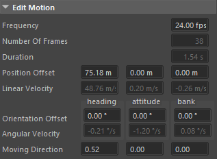

Edit Motion Panel after motion import
In our example, we are extracting a walk cycle from a longer walking animation.

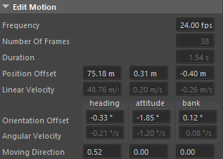

You can see that there is a big position offset on the X axis (because
the character is walking forward), and also small offsets in Y/Z axis.
If you do not correct this, the character will not be walking straight in
front of him, but slowly drifting on the side and going downward
(although this should be corrected by ground adaptation). So you should
set Y / Z position axis to 0, to keep only the X axis difference.
Concerning the orientation offset, we want no offset at all for the character to keep going straight. So change all values to 0.

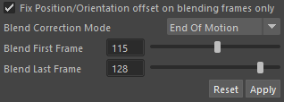

Then you need to choose when the blending between first/last frame will occur (and when the position/orientation fix will occur as well if you checked the "Fix Position/Orientation offset on blending frames only).

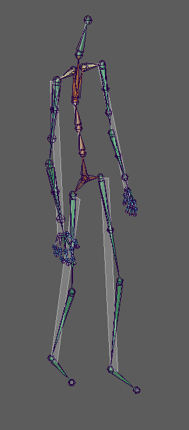

If you check the "Looping motion" on the CharacterMaker locator attributes, and scrub the timeline around the last selected frame, you will be able to see the difference gap between frames which needs to be fixed
Offset after the cropped part of the source motion
You can blend at any points of the motion, not only at start or end. The best moment to fix the offset is when the part which will be fixed is moving.
For example if the part which will be most modified is the Left foot, it is better to fix it while this foot is moving, not when it is supposed to be on the ground (otherwise it will be sliding).
If the difference is too big and every part of the body will be affected, then it is better to distribute the blend on the longer possible period. Just select the whole motion as blending period.
Notice that usually you want to fix the Position/Orientation offset we
discussed in the previous section at the same time as the posture
difference.
But if you want the Position/Orientation offset fix to be distributed
along the whole motion duration, you can uncheck "Fix
Position/Orientation offset on blending frames only"
Do not forget to click on the Apply button, and check the result of your looping motion
