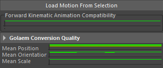

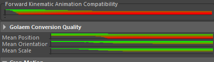

When importing motions, it is important to check the Forward Kinematic Animation Compatibility and Golaem Conversion Quality indicators at the top of the Motion Tab panel.
All green! Congrats!
This indicator checks if the translations values on bones are the same or not than in the .gcha character file you are importing the motion on.

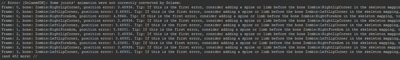

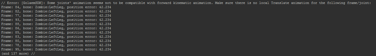

Some problems are detected in Forward Kinematic Animation Compatibility
(which obviously has some consequences on Conversion Quality)
Usual reasons why it could be different:
To know exactly on which bones problems are detected, you can check logs in the script editor

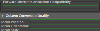

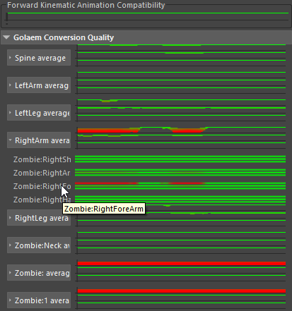

After you checked that the animation can be imported on your character skeleton, you should check if the conversion result was good or not
Although everything seems green, you should expand the quality indicator
to check curves on each bone (see below)
When expanded, the Golaem Conversion Quality indicator shows curves for each skeleton bones.
You can also get more details in the Script Editor logs. The bones with the worst animation quality are shown at the top of the list
Some frequent reasons why conversion quality could be bad
Note that even if Conversion Quality is not perfect, your motions can still be used with Golaem. It just means that the output will be a bit different than the original animation. Sometimes it can be a problem (sliding feet, twisted limbs...), sometimes not. Use the CharacterMaker Locator to check what the consequences of the quality loss are (see below).

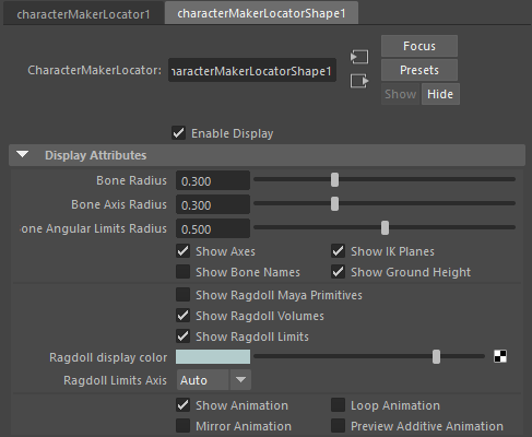

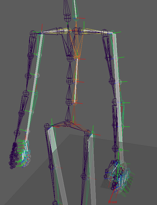

The CharacterMaker Locator can be used for multiple purposes so its default configuration is not always the best to check your motions
CharacterMaker Locator default settings
IK Planes can be hidden to have a better view of the skeleton, but as they can help to understand why an animation has not been correctly converted, we would advise keeping them
To check motions quality, we do not care about Ragdoll Volumes or Limits, you should uncheck these.

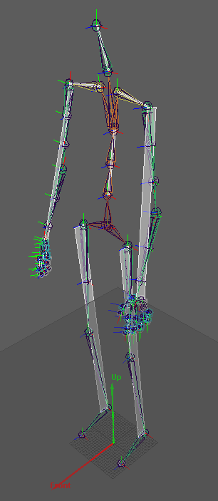

Note that the Golaem skeleton display is influenced by the Maya Joint Size setting. So to setup skeletons display, first adjust the Maya Display / Animation / Joint Size to better see the Maya skeleton
Then adjust the Bone Radius and Bone Axis Radius in the Golaem CharacterMaker Locator
Golaem (colored, with axis) and Maya (dark blue) skeletons with display
sizes big enough to see bones rotations
