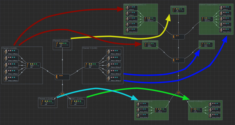

Example of mapping a human motion (left) on a four arm biped (right)

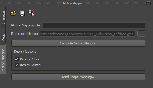

Before creating a motion mapping, you need first to load the character on which your are going to retarget the motion (skeleton B), and a motion exported from skeleton A. You can then compute the Motion Mapping automatically by pressing the Compute Motion Mapping button.

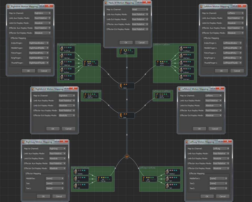

If you want to change the computed motion mapping, right click on a channel rectangle (but not on a limb) and select "Edit Motion Mapping", as explained in the Character Maker Main Workspace help.
You can then edit the channel to which the right-clicked channel is mapped. To view the available channels of a given motion, you can load it in the Character Maker.
Motion Mapping Menu (see the
Main Workspace help for details about
the parameters)

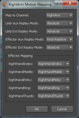

When editing the Motion Mapping of a human morphology, it is advised to set the Replay Mode of the head channel on Rest Relative for all (Limb/Effector, Auxiliary/Extension).
Motion Mapping configuration for the head channel
Here is an example for the complete mapping of a human motion on a biped with 4 arms:
Result of the Motion Mapping of a human motion on a 4 arms biped
(original Motion shown on left)
