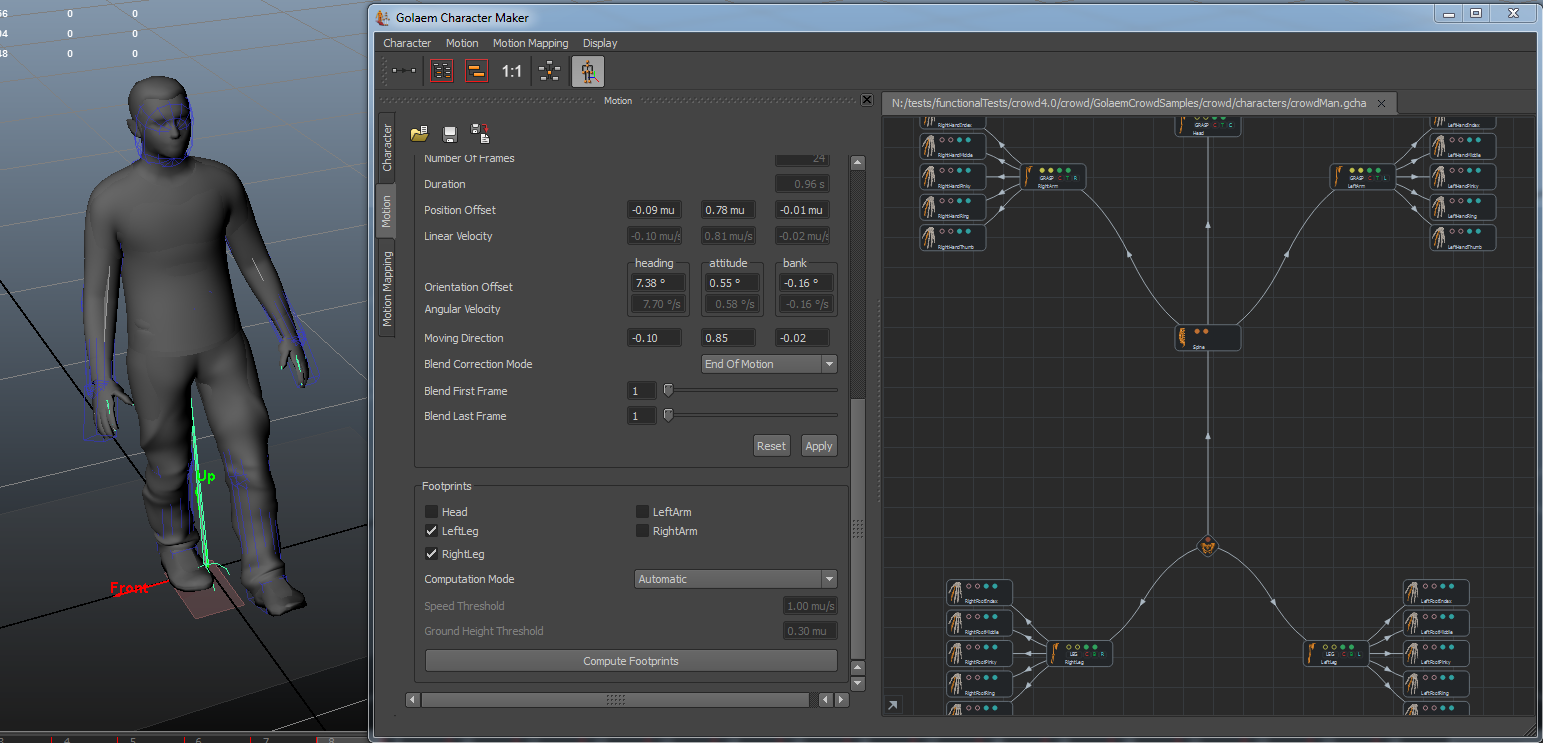

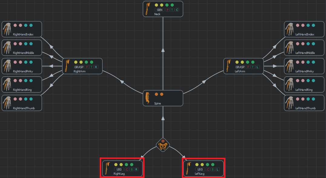

After importing a motion in the Character Maker, go to the bottom of the Motion Tab Panel, and check the boxes of the limbs which should be adapted to the ground (most often the two legs of your character...). Then click on the Compute Footprints button.
Note that the limb names you will find in the Footprints panel correspond to the limbs defined on your character in the CharacterMaker Workspace.
Example of identifying the Channels that need footprints on a loaded
Motion

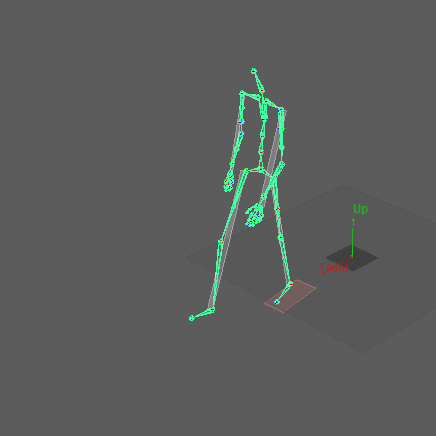

Rewind the simulation, and play it again.

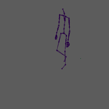

You should see a red box near the feet when they touch the ground. Note that at this point, their exact position or orientation relative to the limbs they are associated with has no meaning. What's important is the timing.

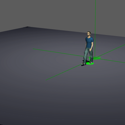

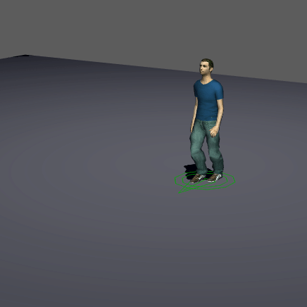

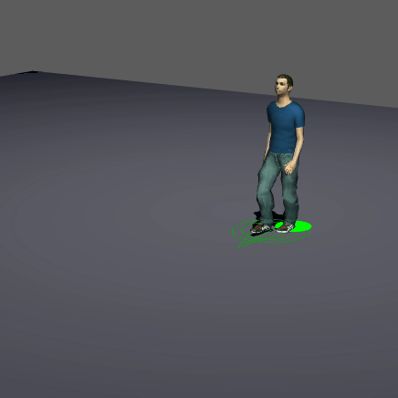

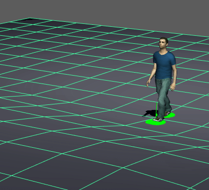

Later, if you want to check footprint on a saved motion, you can click on a character during simulation (and if the footprints option is checked in the Visual Feedback tab / Maya viewport settings), footprints will be displayed as green circles, with a normal vector.
Note that this time, the location and orientation of footprints is what is taken into account to adapt feet on the ground.
Footprints computed on a walk cycle, visualized using the
CharacterMakerLocator (as red planes, left), during simulation (as green
circles, right)

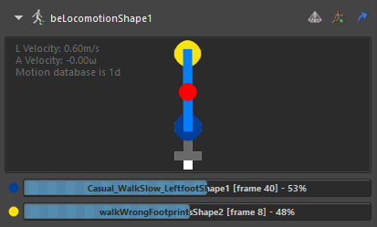

The Locomotion Behavior decides when to make transitions between motions based on footprints (to make sure feet are in the same support / non-support state for each motion used in transition). If footprints are wrong in one of these motions, it will result in bad animation.
To show this, we setup a simple scene with Locomotion, which navigation speed is set to force the character to mix 2 motions: a walk slow motion and a walk normal motion. We used the two different walk normal motions shown in the ground adaptation section (with correct / incorrect footprints).
The only difference in each of the images below is the way the footprints are set in these walk normal motions.
Locomotion with a Walk Normal motion with correct footprints (left) and
wrong footprints(right).

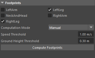

There are two ways you can fine-tune footprints
The manual computation mode enables to define thresholds to compute footprints.
If the feet speed/height are below these thresholds they will considered as in contact with the ground, and a footprint will be added. Do not forget to press the Compute Footprints button after setting your thresholds. The resulting footprint can be seen at once in the viewport by scrubbing the timeline.
Note that depending on the scale of the skeleton used in the animation, you may need to multiply the default value by 10, 100... to actually see some footprints computed.
