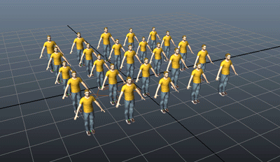

Random Trigger
The Random Trigger enables to start or stop a Behavior randomly depending on a percentage.

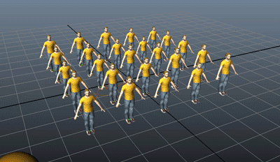

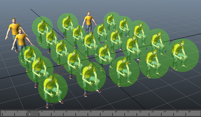

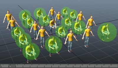

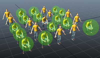

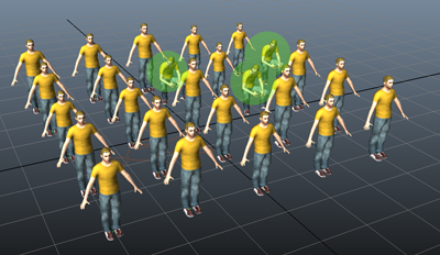

Left: 10% of the Entities sit - Right: 50% of the Entities sit.
As the trigger is evaluated per character and per frame, the wanted percentage is not strictly respected, but will tend to be respected. In the example above, with a 50% of chance to trigger the Sit Behavior, 14 characters are actually sit (on 25 available) which represent 54% of the crowd.
Usually this Trigger is combined with other triggers to add variety and some delay to start or stop a behavior. If this Trigger is used alone, it will be evaluated at each frame until it returns true: it means that with a 50% Random Trigger, everybody will tend to be sat at frame 3:
*"1 in 2" Random Trigger to start the Sit Behavior - Left: Frame 2 - Right: Frame 3.*

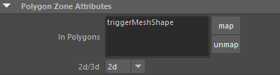

Polygon Zone Trigger
The Polygon Zone Trigger  enables to start or stop a Behavior when the Entity is located in a Maya mesh. The Zone is represented by a Maya mesh, which can be animated and can be either planar or a volume.
Left: Example of a 2d Zone Trigger - Right: Example of a 3d Zone Trigger
Refer here to learn how to map a Maya mesh to a Zone Trigger.

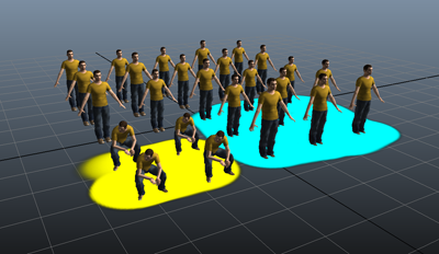

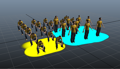

Painted Zone Trigger
The Painted Zone trigger  enables to start or stop a behavior by returning true when the position of the root bone of an Entity is contained in a painted zone of a specified color (the painted zone being represented by a Painted Zone Locator).

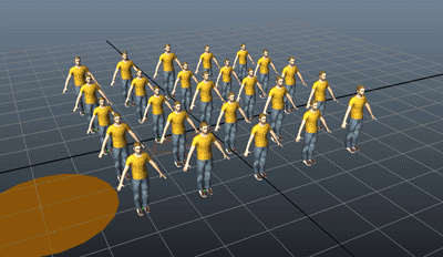

Left: Entities are in the Yellow zone - Right:Entities are not in a cyan zone

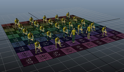

Texture Trigger

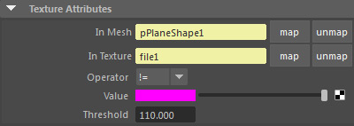

The Texture trigger enables to start or stop a behavior by returning true when the position of the root bone of an Entity is contained in a zone of a specified color of a Maya 2d or 3d Texture.

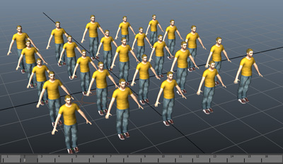

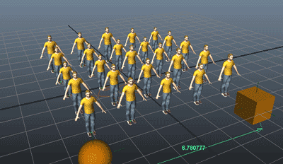

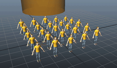

Distance Trigger

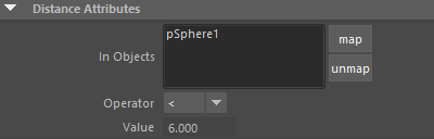

The Distance Trigger enables  to start or stop a Behavior when the Entity is close enough / far enough to a Maya object. The Maya object can be anything, from a camera node (to deal with LOD) to a Maya mesh and can be animated. If the object is a Maya mesh,  notice that the Distance Trigger works with the bounding box of the mesh and not the actual hull.
Refer here to learn how to map a Maya object to a Distance Trigger.
This Trigger can be useful to load a different LOD geometry depending on the camera distance, make Entities flee when they get close to a dangerous area...

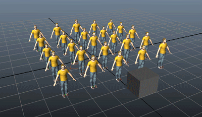

The Driven Attribute Trigger  enables to start or stop a Behavior when any Attribute of any Maya object reaches a specific value. The Attribute can be anything from a rotate component of a Maya mesh to the diffuse value of a shader. It can be keyframed, controlled with an expression or changed interactively by the user within Maya.

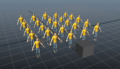

Left: Entities sit when the scale of the cube reaches 0.5 or less  - Right: Entities sit when the red part of the color of the cube reaches less than 1 or more.

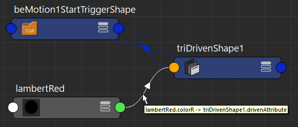

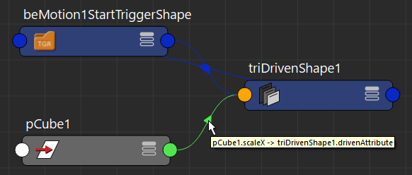

Refer here to learn how to connect a Maya Attribute to a Driven Attribute Trigger.

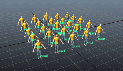

PPAttribute Trigger
The PPAttribute Trigger  enables to start or stop a Behavior when an Entity PPAttribute reaches a specific value. The PPAttribute can be dynamic. Refer here to see how to easily set and control PPAttributes.

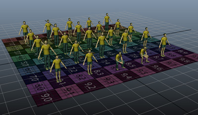

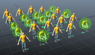

Left: Entities with a particle id PPAttribute less than 10 sit - Right: Entities with a myTriggerPP PPAttribute more than 70 sit (the PPAttribute value is incremented with a ChannelOperator Behavior).

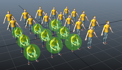

Left: Entities with a particle id PPAttribute less than 10 sit - Right: Entities playing "sit" behavior, stopped according to the currentFrame channel after playing 18 frames.

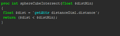

Script Command Trigger

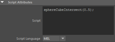

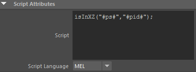

The Script Command Trigger  enables to start or stop a Behavior when a MEL/Python function returns true. You can use the special tags #ps# and #pid# to use the Entity corresponding particle system name and particle id in your code.
Left: Entities sit when the sphere and the cube intersect - Right: Entities sit if placed in XZ
This Trigger is useful to extend the library of provided triggers with custom function. As almost everything in Maya is queryable with MEL/Python, it lets you create almost any test.

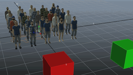

Physics Collision Trigger

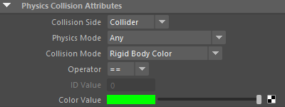

The Physics Collision Trigger  enables to start or stop a behavior when a collision with another physicalized entity or a Crowd Rigid Body occurs. The trigger only works when both entity are physicalized with the Physicalize Behavior.
With such a configuration, entities only react when they're in collision with a green Rigid Body.

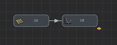

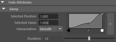

The Fade Trigger  lets you delay the action of Triggers attached to a Behavior using a ramp.
Result of  the previous attached Polygon Zone Trigger will be spread on 10 frames.
