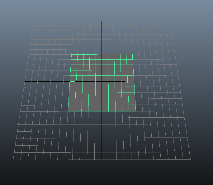

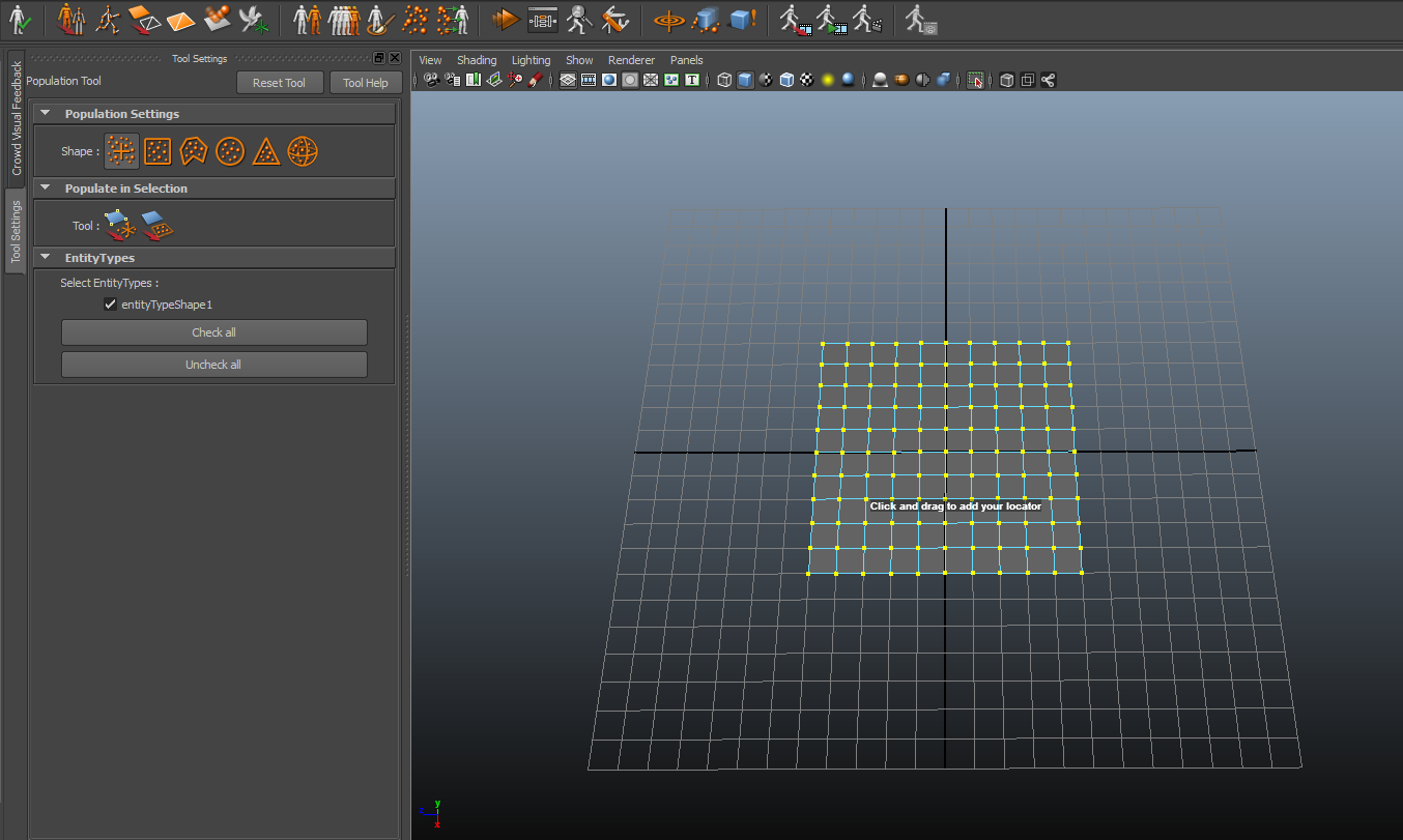

4. Create a pPlane and shape it to your will as we are going to create the entities on each vertices.

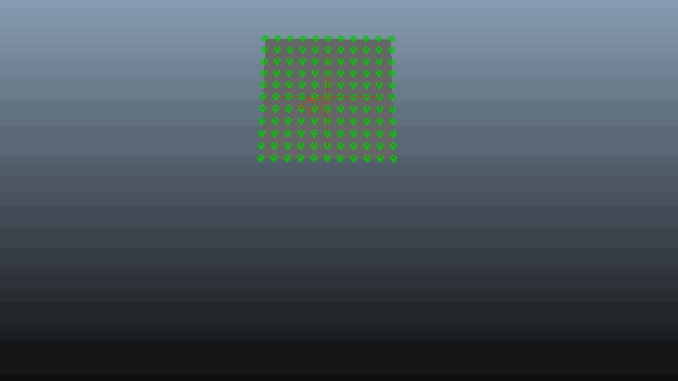

5. Go into the Population Tool settings. Select your pPlane vertices using the Maya component mode selection and click on the Population Tool "Create Particles On Selection Or Components" .

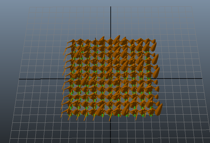

6. Click the Create button in the Population Tool attribute editor to create a particle system and link it to a Crowd Field. Your formation is now placed.

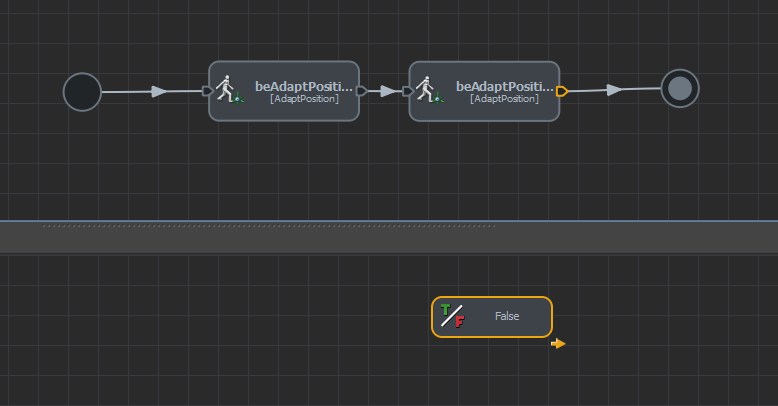

7. Open the Behavior Editor  and double-click on your EntityType.

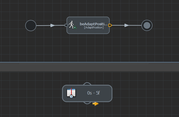

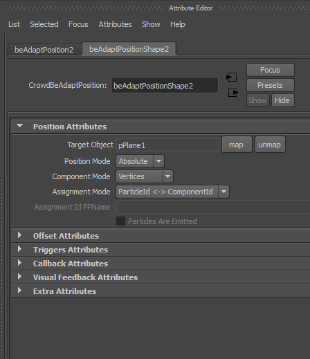

8. Drag and Drop an Adaptat Position Behavior   in the Behavior flow.
9. Edit the Behavior attributes to map the creation Geometry pPlane  as a Target object. Set the Position Mode to Absolute and the component mode to Vertices.
10. In order to play some other Behavior after this one, edit its end Trigger and set it to end after 5 frames.

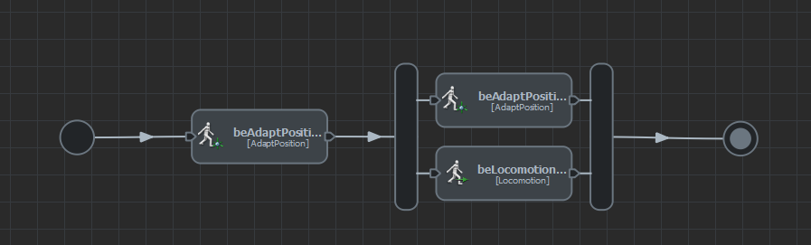

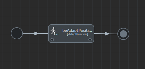

11. The first Behavior allow us to assign entities to a vertice. In order to make your crowd move, we are going to drive the particles on the vertices of your pPlane. Drop another Behavior AdaptPosition  behind the previous one.
12. Edit its attributes exactly as the previous one but this time set its end Trigger to False.
13. Animate your pPlane, and play your simulation, your entities are now following their assigned vertices.
Make them move
14. Drag and drop a Locomotion Behavior and its motions (or drag and drop a previously saved Locomotion Behavior template) on the second Adapt Position Behavior to create a Parallel Operator.

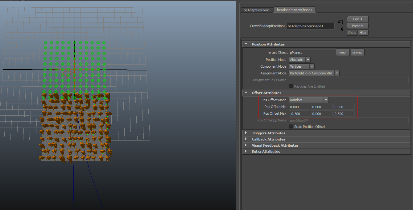

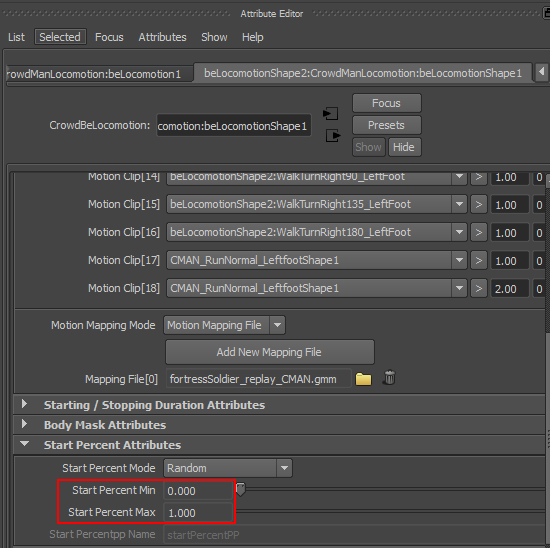

18. You can use the Offset Attributes to add some noise on the character positions
15. You can also use the attributes of the Locomotion Behavior to randomize animation, for example the Start Percent attributes
