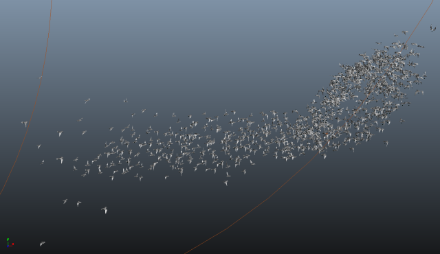

snapshot of what a seeking flock may looks like, target is shown by
translating tool gizmo
Leading a flock to a target is easily achieved by adding a Steer Behavior.

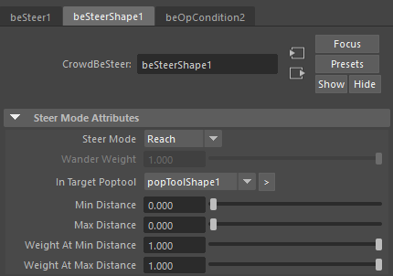

The Steer Behavior should looks like the following image:
Steer Behavior configured to reach a target, with constant weight

By default, the target will attract/flee boids from any distance at its maximum weight (1.0).
Weights control :
To have an absolute target weight other than one, just move Weight At Max Distance value from 1.0 to less. As Max distance is 0, this value will be used for all boids (see below).

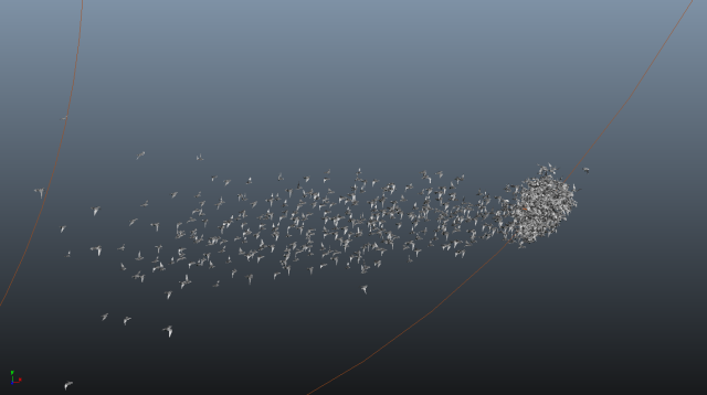

Here is a quick overview of weights impact :
Default SteerBehavior parameters

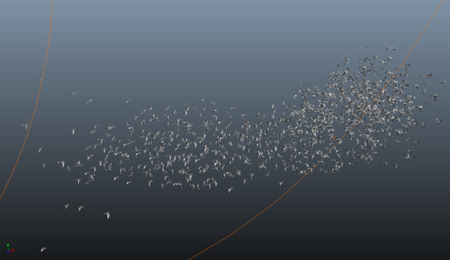

Same frame, with Steer Behavior Min Distance set to 40.

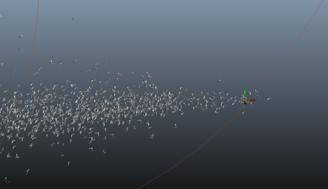

We can improve the natural effect by also increasing the separation of flock, in the Flock Locator. Let's set separation weight to 20 instead of its default 12 value :
Same frame, with a Min Distance of 40 and a Flock Locator separation
weight of 20
