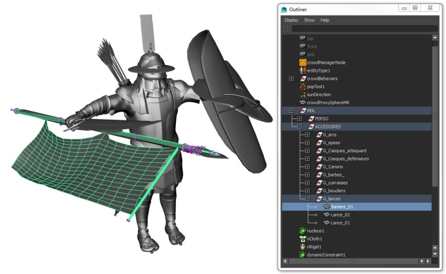

To add cloth simulation to any of your asset, the first step is to import its geometry file (fbx or gtg), and then configure cloth on the imported objects using nCloth and nRigid nodes. Please refers to the Maya documentation about the cloth simulation, as Golaem Crowd only duplicates cloth nodes but don't make a simulation of its own.
Only Maya nCloth, nRigid and constraints are duplicated in a Golaem Crowd simulation.
*In this case, the Baniere_01 is going to be configured as a nCloth, constrained on the nRigid Lance_02.*

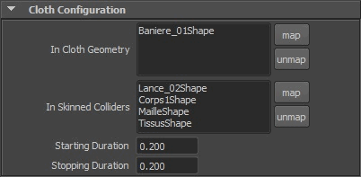

- Configure the Cloth Behavior by adding the nCloth object(s) in the "In Cloth Geometry" list, and the nRigid object(s) in the "In Skinned Colliders" list. The list should at least contain every objects that are used to constraint the objects in the "In Cloth Geometry" list, but other nRigid objects can be added also for collisions purposes.
All the meshes listed in the Cloth Geometry must be attached to a nCloth node, while meshes listed in the Skinned Colliders must be attached to a nRigid node. All of them must be listed as Meshes in the Geometry Tab of the relative Character File with the exact same name (beware of namespaces).

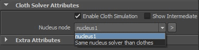

By default, the nucleus solver that will be used for the cloth simulation will be the same as the one connected to the nCloth object. But a separate nucleus solver can be used for the cloth crowd simulation by changing the option in the ClothLocator:
This is particularly useful to disable the cloth simulation on the source cloth objects while enabling it on the Crowd simulation. It also lets you configure the Nucleus solver with settings for better performances (but lower quality). Please refers to the Maya documentation about the nucleus node.

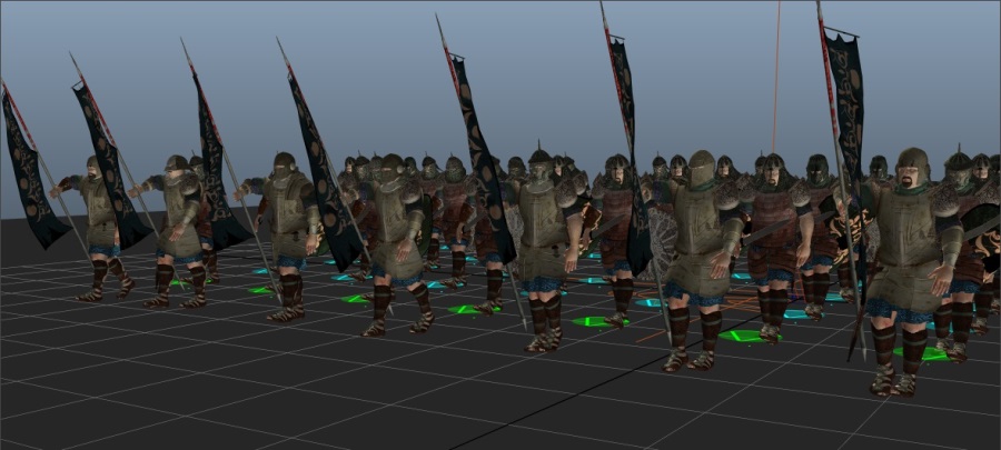

The simulation can now be run like any other Crowd Simulation, and clothes should be visible for both the previsualization and render with nothing else to configure.
Previsualization
Render

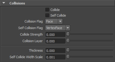

The Maya nucleus solver can take a lot of time to do the cloth simulation. here are a few hints to help reduce the simulation time:
Even with collisions are disabled, the other parameters have influence on the nucleus simulation framerate
