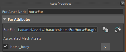

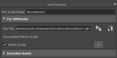

Each Fur Asset node is automatically linked to the Mesh Asset(s) on which the fur is generated. This information is shown in the Asset Properties panel (see image below). The fur meshes must be present in the Maya scene in the same pose as the one defined in the Golaem character.

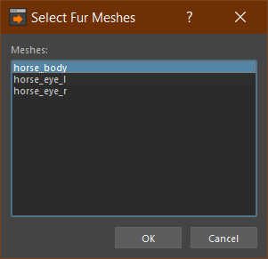

  2. Select the fur mesh(es) on which to generate the fur (among the Mesh Assets already present in the Golaem character)
  3. Select the file to which to save the Golaem fur. After a processing step, this Golaem fur file and the associated Mesh Asset(s) will appear in the Asset Properties panel. A message in the script editor will show the number of curves that were successfully imported from the Alembic file.

  1. Select the fur mesh(es) on which to generate the fur (among the Mesh Assets already present in the Golaem character)

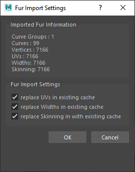

It may sometimes be difficult to import everything from a single source (Xgen, Alembic, Maya curves). You can mix different imports by reimporting some data from an existing and configured fur asset node. If you attempt to import some fur from an already existing fur asset, you will reach this window:
 It will display what is mergeable in the new import, based on the total curve count, among UVs, widths & skinning information. A mergeable source is a source with the same count of curves, forbidden merge will be grayed.
If you wish to reimport totally a fur asset, just clear the Fur File field, and import again.

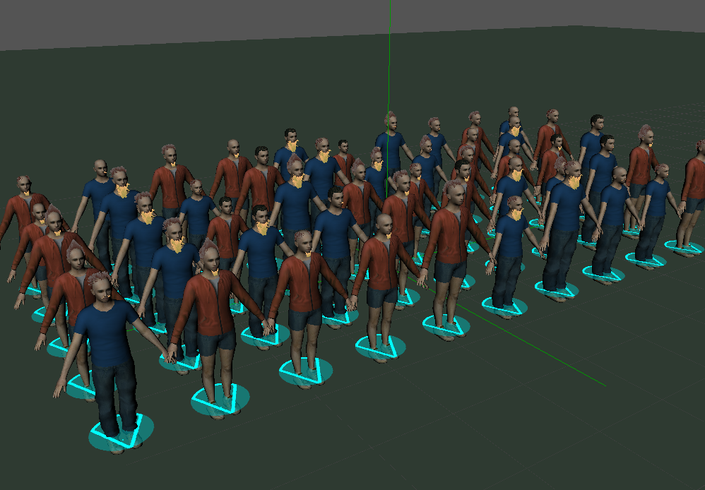

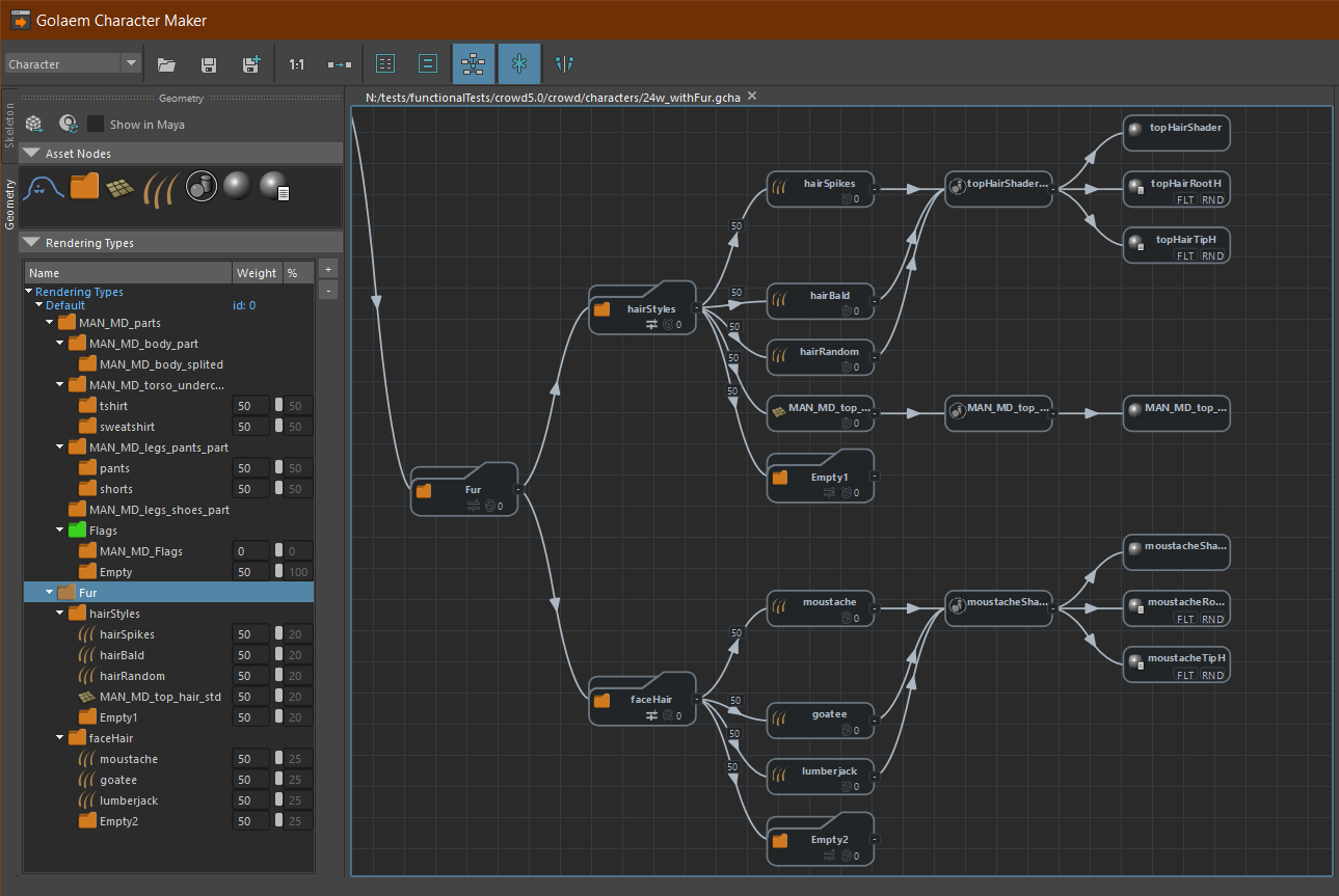

Fur Assets follow the same rules as Mesh Assets regarding asset variation, and they can be mixed with Mesh Assets in the same Asset Group. To create Fur Asset variations, connect several Fur Assets to a weighted Asset Group node (see documentation here). The only additional constraint for a Fur Asset to be selected is that the associated Mesh Assets be selected, as fur cannot be generated without its supporting mesh(es). See below an example of Fur Asset variations.
Example of Fur Asset variations

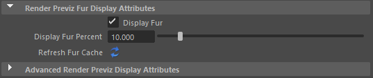

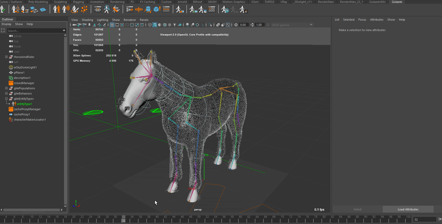

Fur can be previewed in Maya's Viewport 2.0 only in Cache Replay mode. To enable Fur previz, select the Simulation Cache Proxy Manager node and enable the Display Fur attribute in the Render Previz Fur Display Attributes group. You can also change the percentage of rendered fur with the Display Fur Percent attribute. This will only affect Viewport display, it doesn't apply to rendering.
Fur Previz Attributes
Fur previz is computed on the fly when changing the current Maya frame and stored into a memory cache. To refresh it, click on the Refresh Fur Cache button. If you edit the Simulation Cache Layout, you must save the Layout file and refresh the fur cache or switch to a frame that hasn't been cached yet to see the Fur previz changes.
Example of Fur Previz in Maya's Viewport 2.0

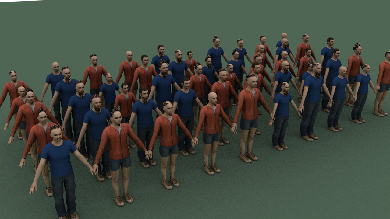

Once the Fur Assets properly set up, just hit the render button. Shader variations work just like for Mesh Assets (see the texture / material diversity and color variation tutorials).
Example of Fur render in Arnold
