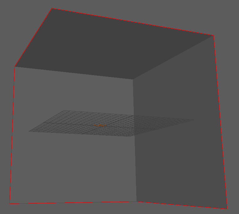

Create a big cube representing our room. There is no UV configuration involved here, as we will be using the 3D geometry directly to populate & navigate. Instead, we will ask Golaem to generate the NavMesh directly from the geometry (one triangle = one navigable cell, so the mesh should not be too defined or it will take forever to compute a Navigation Mesh). We suppressed 3 of the cube faces to have a best view of upper roof. We also reverted normals, as the faces that we are interested in are the internal ones. The cube normals will later give the up orientation of insects, thus it is mandatory. Select the cube and compute a navmesh with it so that our characters will be able to stay inside when navigating. Choose "Generate NavMesh from MayaMesh triangulated faces" in the dropdown choices.
  As the normals drive the "up" vector of our entities, and also their raycast to find the ground, the normals around 90° edges should never be hard normals (per face) but smoothed ones (per vertex), in order to let the entity adapt from a face to the other smoothly. It's up to the artist to choose which distance will best fit the needed result.
You should end up with a NavigationMesh looking like this :
Note that you may need to adjust the unit depending on the size of your cube/characters.

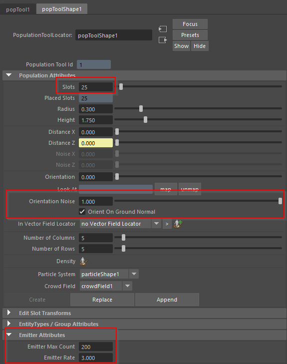

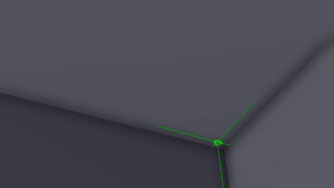

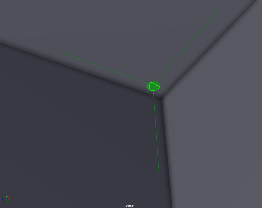

Next we are going to make our characters being generated. A simple Population Tool with the "Orient On Ground Normal" option checked, setup as an emitter, will generate the insects as expected. This is assuming the normals have been set correctly previously. You can also rotate the Population Tool to define the direction in which the slots will be projected.
Create your EntityType, and load your character file. If you use the arachnid from character pack and have a cube around 20-30 units, use a scale around 0.002 as the arachnid model is huge (200+ units unscaled). Adjust its min/max scale if needed, depending on the scale of your environment.
Then add a Population Tool on the upper face and adjust its radius if needed, select "Orient On Ground Normal" option. In this tutorial, we will use only one slot to give the feeling that arachnids are rushing from a wall hole. Then we need to set the Emitters attribute Emitter Max Count (maximum number of generated entities during the whole simulation) and Emitter Rate (nb of emitted characters per second)
And click create. This is very important as it will init the particle system in which entities will be generated.

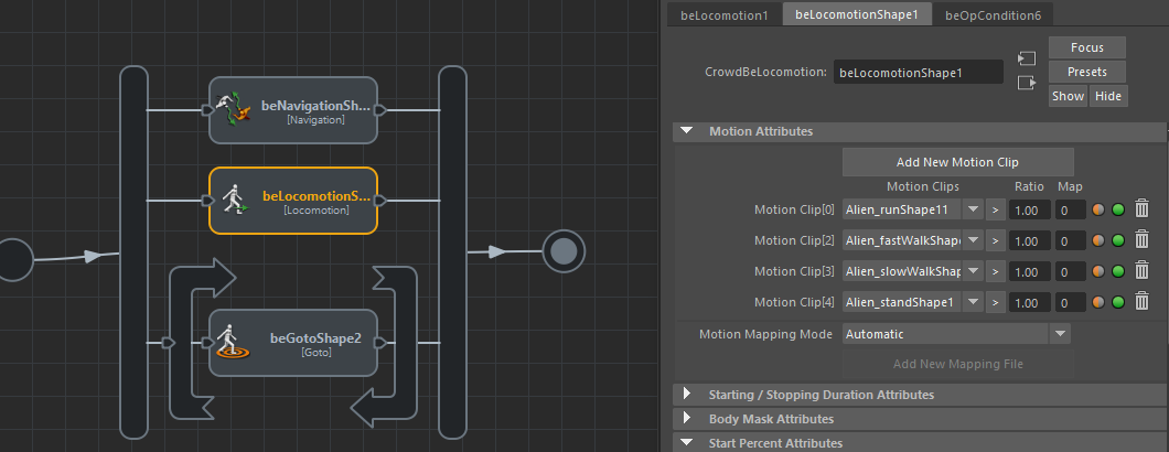

As usual, add a Navigation Behavior and a Goto Behavior in parrallel. You will notice that we embedded our Goto Behavior in a Loop Operator, so that the characters keep finding and reaching a random target. Otherwise they would just stop after reaching the first target they choose.
Then add a Locomotion Behavior with different motion speed and a rest motion.
