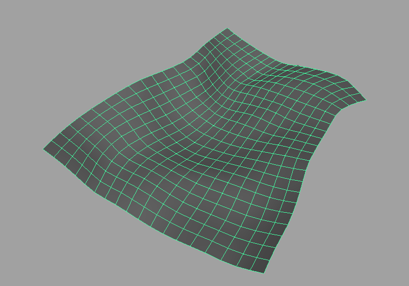

1. Set your terrain as a nMesh passive collider.

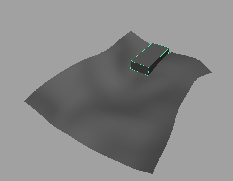

2. Create a shape to fill with particles.

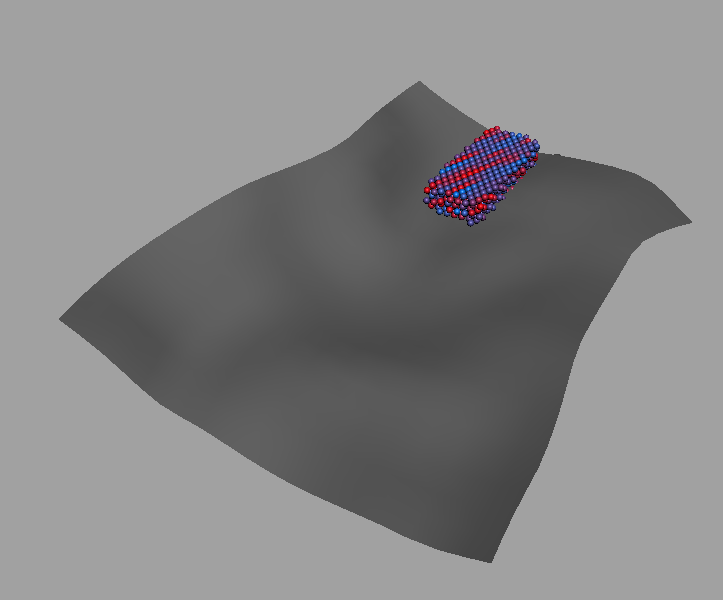

3. Fill with nParticles

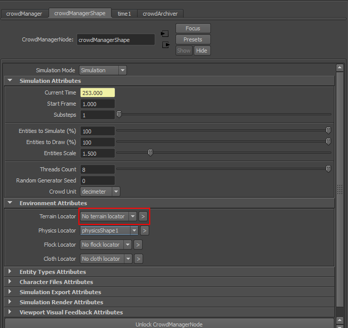

7. Remove the terrain from the crowd Manager as we aren't going to use it.

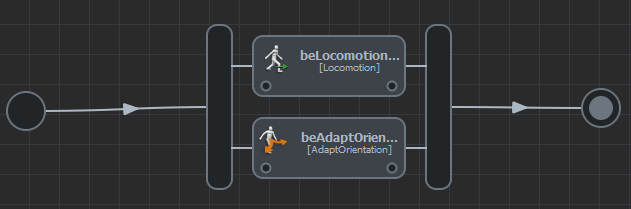

8. In the Behavior editor, go inside your entityType Container  just add a Locomotion Behavior (fill it with your motions set) and an Adapt Orientation Behavior  (change its mode to velocity based).
