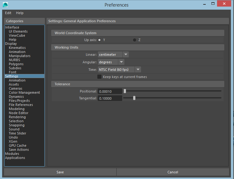

To achieve better physics simulation when it comes to collision between entities and rigid bodies, multiply the frequency. To do so, open the Maya Preferences window (Windows > Settings/Preferences > Preferences) and under Settings change the Time to 60 fps. This way the collisions will be detected quicker and though will be more accurate. Inside the Time slider Tab change the Playback speed to Real-time 60 fps.
After changing these settings, make sure that the first frame of the time slider range is 1, otherwise, you may skip the simulation initialization when playing.

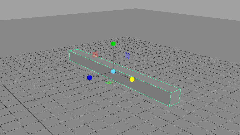

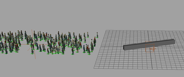

2. At the center of the scene create a Cube and scale to give it a the shape an horizontal bar.

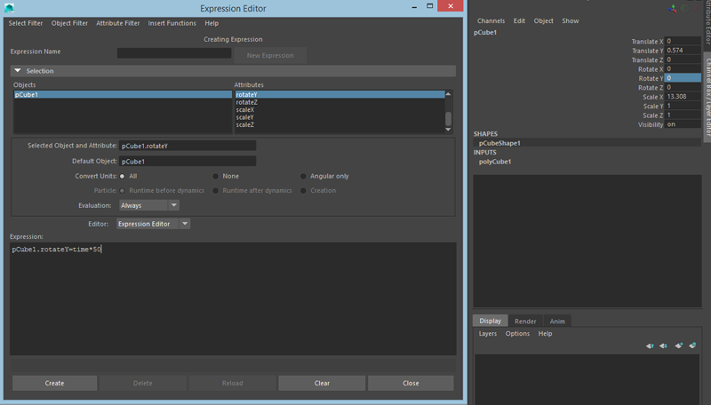

3. Select this Box and inside its channel editor create an expression on the Rotate Y channel to make it spin: pCube1.rotateY=time*50

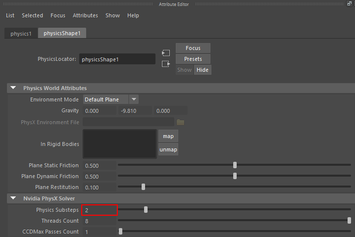

5. When creating a Crowd Rigid Body, you will notice that Golaem
automatically added a Physics Locator
in
your scene. Because we already increased the scene fps, we do not really
need physics to have a lot of substeps in one frame, so let's set its
Physics Substep to 2 instead of 3.

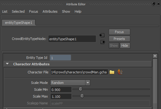

6. Create an
EntityType
and
browse to find the Character File (.gcha) in the /crowd/characters
directory of the Samples Pack.

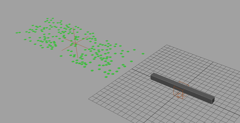

7. Click on the Population Tool
icon
and then click at one
side of the bar collider to place a Population Tool Locator.
8. Adjust at your will the Population Tool parameters in the Attribute Editor. Edit the orientation to make them face their future collider.
9. Click on the Create button to create a particle system and link it to a Crowd Field to instantiate characters on top of your particles.
10. Click the play button to visualize the created characters. They are not moving yet.

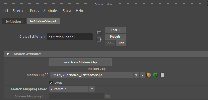

12. Drag and drop a Motion Behavior
and
load the Run motion provided in the character Pack.

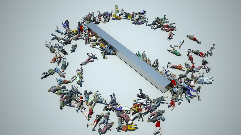

13. Play your simulation, your entities now go to the target but pass through the bar, they are not in the Physical world yet.
14. Drag and drop a Physicalize Behavior
on top of the Motion Behavior
to embed both of them in a Parallel Operator
It is recommended to let the start trigger of the physicalize operator to TRUE. so that the character enter the physics world as soon as the simulation starts, and they do not suddenly pop into the physics world when switched to another mode.

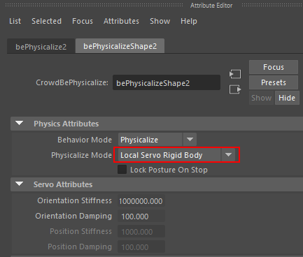

15. Go inside the attributes of this Physicalize Behavior and change the Physicalize Mode to Local Servo Rigid Body.
16. Unlike the other behaviors, the Physicalize Mode mode of an Entity only happens when the behavior is stopped.

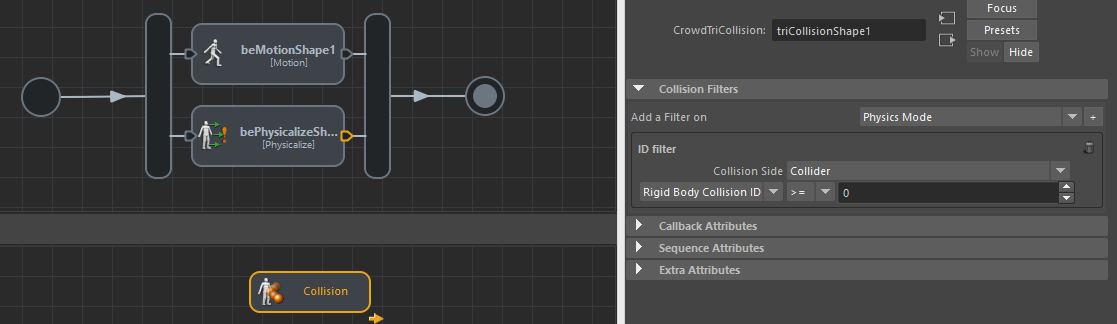

Double-click on the Stop Trigger of the Physicalize Behavior to edit it in the Trigger Editor. Drag and drop a Collision Trigger and select ID in the top list widget and click on the + button next to it.
Then sets its attributes to Rigid Body Collision ID >= 0. Rigid Body
Collision ID are values that can be set when created a CrowdRigidBody
(see here).
>=0 basically means that a collision with any CrowdRigidBody will
activate the trigger.
Do not forget to right-click on the added trigger and set it as root trigger so that it is evaluated.
17. Play your simulation.
