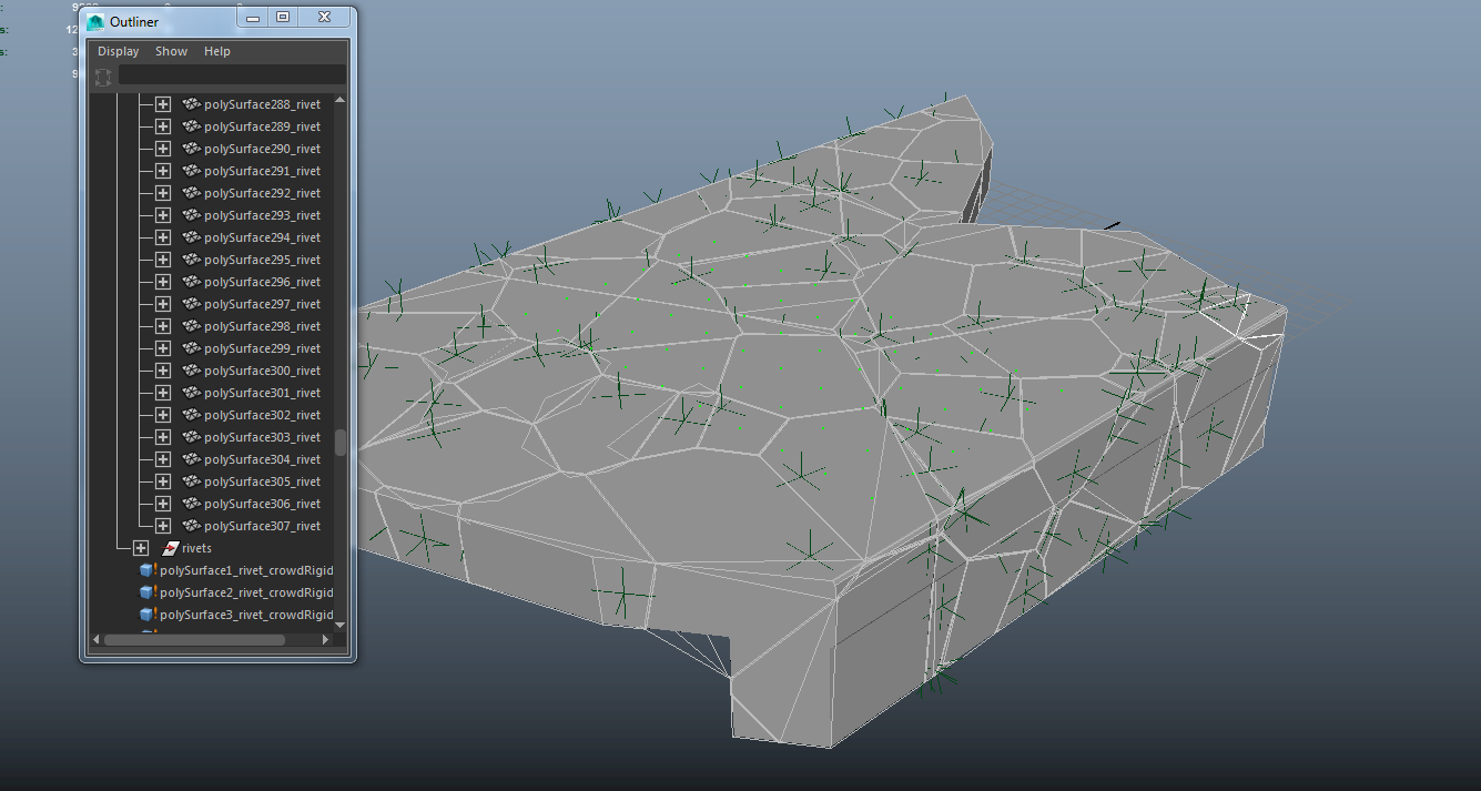

1/ Select all your Alembic cache meshes (select the mesh transform nodes, not the group)
2/ Call the function glmTransferVerticesAnimToTransform(). It will duplicate all the meshes you have selected, and transfer vertices animation to the mesh transform using some Maya constraints. This should create a new group in your scene called bakedGroup.

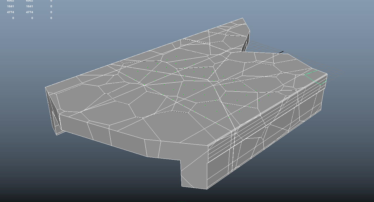

Now you'll have two deformed geometries : one Alembic, one using the constraints
Both should be animated similarly:

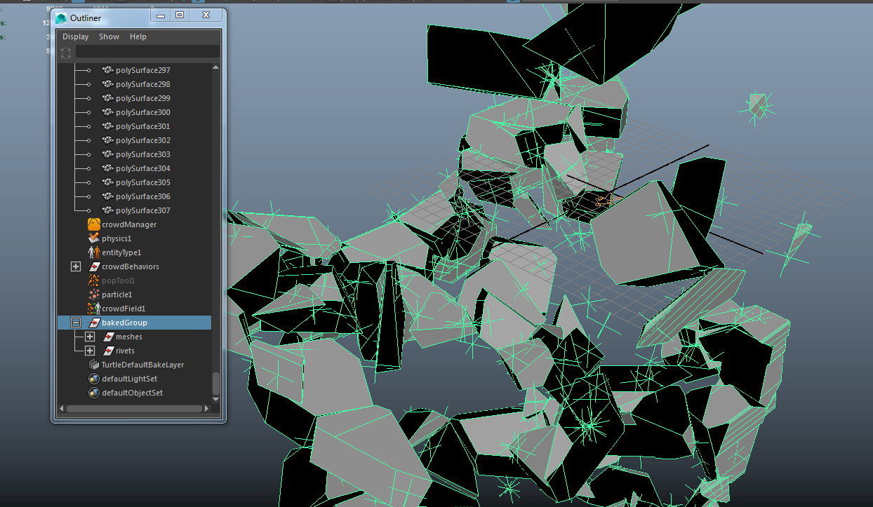

3/ Select the mesh nodes in bakedGroup/meshes (the mesh nodes not the group) and click on the Crowd Rigid Body node in the Golaem Shelf. This will create the Golaem Rigid Bodies for each of those newly created nodes. To improve sim results, you may switch the crowd rigid body nodes shape type to Convex Hull.

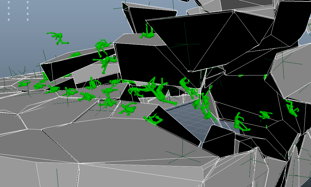

4/ Hit play, Golaem entities shall now collide with the new Golaem Rigid Bodies.
