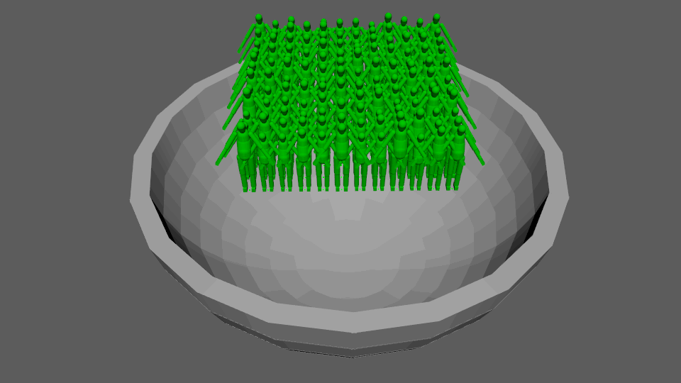

Let's consider one wants to create a cup that should hold falling ragdolls, and let's look at all the small things that might occurs while preparing an environment or rigid bodies to use with a ragdoll simulation.

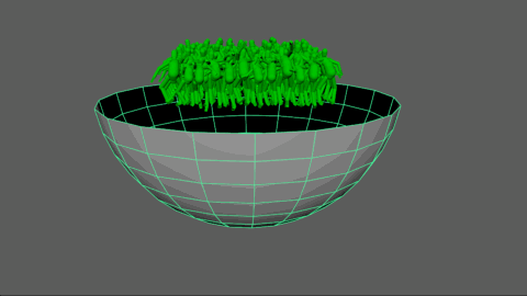

The easiest way to make such a scene is to create a sphere, delete the upper half, and use the object as a Crowd Rigid Body. Once done, here is the result:

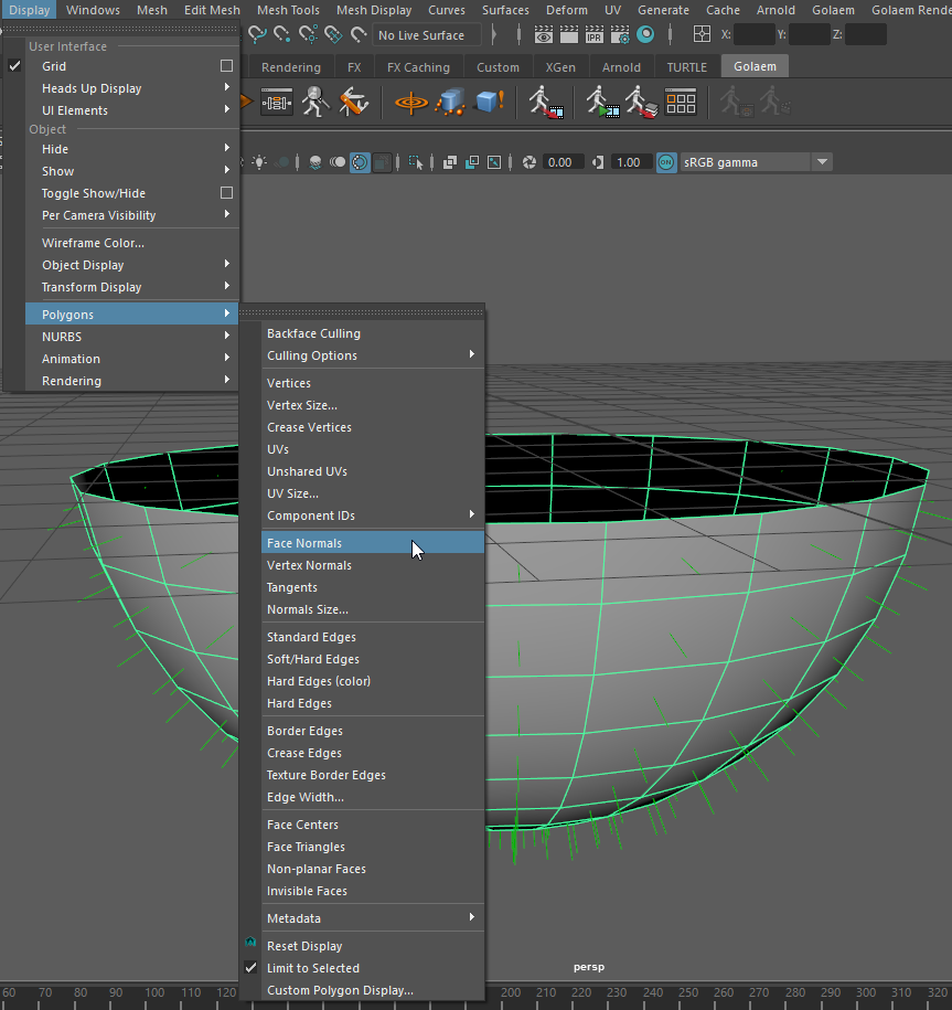

The first thing to check is the face normals. Switch the display on from the Maya menu:

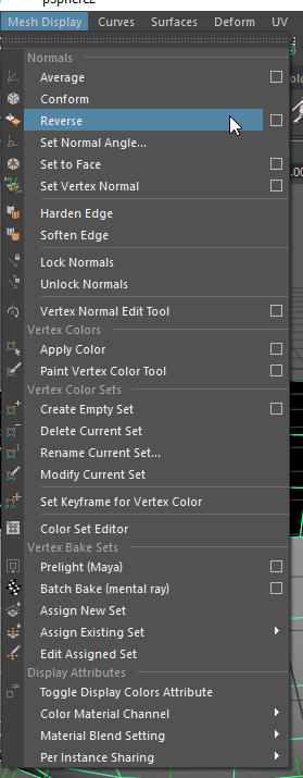

In our case, the normals are facing outside the sphere, while the collision engine considers a face should collide with an object only if the normal is facing the object. Reverse the normals using the Maya menu:

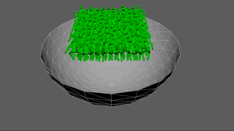

Now that the triangle mesh is fixed, the collision detection is working, but most of the ragdolls are still going through the cup.
The reason now is that triangle mesh collision detection is the most difficult one to handle with physics. The best is to use something else that triangle mesh (see the Convex Hull part at the end of the page), but if one really needs a triangle mesh, then the best is to increase the frequency of the physX solver by increasing the Physics Substeps in the Physics Locator parameters.
The result is now fine, but if you try it by yourself, you'll realize that the simulation framerate decreased by a factor of ten.
Sadly, that's the best solution if you really want to stick with triangle mesh.

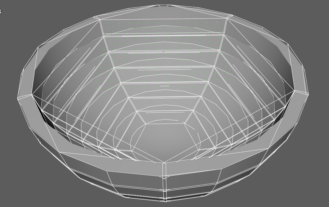

Concerning the cup, faces were grouped by 4, detached and separated before being extruded, and here is the result:
The cup with the convex hulls (white stripes) that approximate its
shape

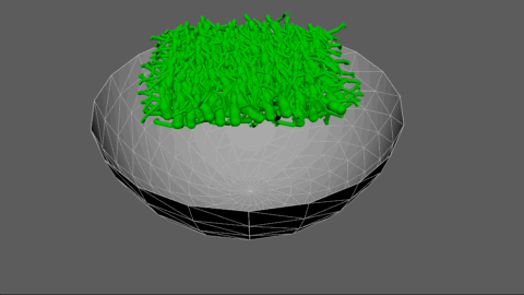

The result is now quite better, and the simulation framerate is far better (the substeps value has been set back to 3)
