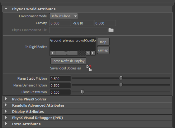

The Physics locator let you set the environment mode to Default Plane , File or None.
The environment is set to Plane by Default you may adjust the physics attributes of this Default Physics Plane (Static Friction, Dynamic Friction, Restitution) inside the Physics Locator attributes.

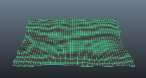

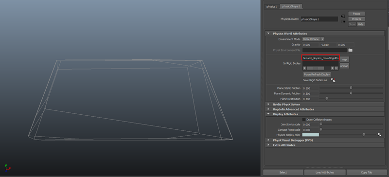

1. Select the desired mesh you want to Physicalize.
 2. Click the Crowd Rigid Body icon  in the Golaem Shelf, your new Rigid Body will be automatically mapped into the Physics locator.

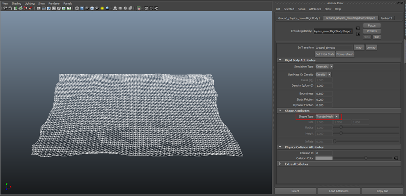

3. Go inside the attributes of the Rigid Body to change its Shape type and Physics properties if needed.
Rigid Body of a terrain set to Triangle mesh

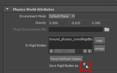

To transform your environment in a PhysX environment file, just click the icon "Save Rigid Body as" and save it to the desired location.

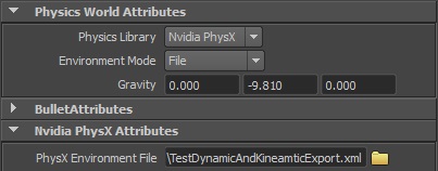

When creating your simulation with Golaem Crowd, set the Environment Mode to File, and set your previously exported PhysX environment file in the PhysX Envrionment File attribute.
PhysX .xml file loading
